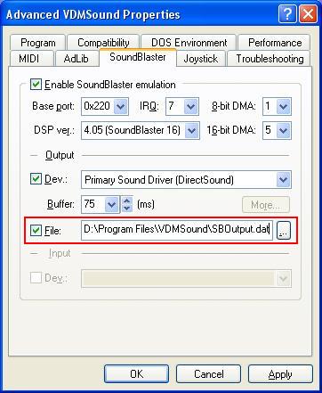

Reply 3 of 7, by Guest
MiniMax wrote:
vladr wrote:
No, disbaling it in LaunchPad should stop the sound.
Well, it doesn't 😕
Anyone here that can confirm that the LaunchPad in 2.1.0 beta is able to disable the sound device?
At the properties tab for MIDI, AdLib and Sound Blaster you have to option to choose the output method: a sound device and/or a file. You can disable the device and send output only to the file, if you want.
Regards,
    38.67 KiB
    636 views

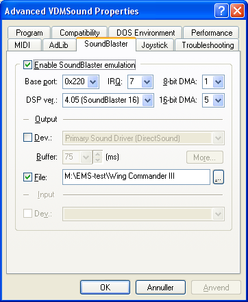

Reply 5 of 7, by MiniMax
Rank Moderator
Moderator
But did you try it? Did you try this configuration (see attached screen capture)? Did you hear any sound?
This is the INI-file that VLP generated for me:
[*.debug]
detail=0
file=M:\EMS-test\Wing Commander III\VDMS.log
[VDMServicesProvider]
CLSID=VDDLoader.VDMServices
[VDMServicesProvider.config]
fixPOPF=0
[DMATransferManager]
CLSID=DMAController.TransferMgr
[DMATransferManager.debug]
detail=0
[DMATransferManager.config]
minDMAPeriod=5
maxDMAPeriod=15
[DMATransferManager.depends]
VDMSrv=VDMServicesProvider
[SBController]
CLSID=EmuSBCompat.SBCompatCtl
[SBController.debug]
detail=0
[SBController.config]
version=4.05 (SoundBlaster 16)
port=0x220
IRQ=7
DMA8=1
DMA16=5
[SBController.depends]
DMACtl=DMATransferManager
WaveOut=SBWavePlayer
[SBWavePlayer]
CLSID=DSoundDevice.WaveOut
[SBWavePlayer.debug]
detail=0
[SBWavePlayer.config]
device=-1
buffer=75
[SBWavePlayer.depends]
WaveOut=SBWaveWriter
[SBWaveWriter]
CLSID=DiskWriter.WaveOut
[SBWaveWriter.debug]
detail=0
Show last 3 lines
[SBWaveWriter.config]
path=M:\EMS-test\Wing Commander III
I don't know if I have understood the format of the INI-file correctly, but it seems like the SBWaveWriter is a dependent on the main SBController? So if output to a file is selected, then the sound device is automagically also active?
Have you tried to disable *BOTH* the device and the file? I have, and I got sound anyway!
MiniMax
    31.6 KiB
    627 views
    Deselecting the device, selecting the file.
_________________
Reply 6 of 7, by MiniMax
Rank Moderator
Moderator
I think I got a silent recording now. I had to hand-edit the INI file, so it read
;WaveOut=SBWavePlayer
I ran the game in total silence, and got a nice vdms0001.wav file at ~1 MB in size. And the crackling was still there. So I guess that rules out the actual audio hardware from the equation.
MiniMax
_________________
Reply 7 of 7, by vladr
For LaunchPad: yeah, that was a silly copy/paste typo thing, SB and FM "device" output would always be enabled no matter what. It's fixed in CVS now, and will be picked up by the next build (whenever that will happen).
V.
