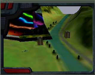

Oops. Appears to be an issue with the full "Extreme Assault" (not the demo) and GliDOS.
Starts with flashing texture errors (alternates between correct texture and garbage). It's distracting but not critical as it appears to only happen on background textures. A much greater concern is that the emulation locks up whenever I restart a mission or try to proceed to the next level. Only solution was to kill the Glide server and restart (game restarts at the proper point).
Worse still though,...it appears that GliDOS won't work with the retail version beyond the 4th mission. Locks up. I can switch back to software mode and proceed just fine.
Will test further...(posting example pic)

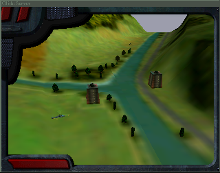

Reply 17 of 27, by Nicht Sehr Gut
Snover wrote:
...but they were resolved with a patch. It sounds like there isn't one for Extreme Assault..?
Jumped on over to BlueByte and I was surprised to see multiple patches (as well as add-on levels) _still_ available. Not bad for a 5 year old game.
Patched up to v1.23 (the latest) and found that all the texture problems and Next-Level/Restart Lock-Ups were gone. Unfortunately, I also found that the framerate had sunk...like the Titanic. Not playable on a Celeron 1.7GHz. Ech.
So, I started some step-by-step checking and found out a few things.
First, the Good news. The v1.20 patch will alleviate all the previous problems without killing the framerate. This appears to be true up to v1.22. Struck me as odd since v1.23 was the only one that specifically mentioned the Voodoo in the changes (then again, v1.23 makes changes tailored for the Voodoo2. That should have been a clue for me).
Now the bad news, there's a minor problem with "mission briefing" windows not appearing correctly. They are partially obscured by the "frame" on your display. The other is that 640x480 was the _only_ resolution I could get to work. All others refuse to display the 3dfx graphics. I also got some "sparkles" at the edges of some things, but that's very minor.
So, it's mostly good news. Patch the game immediately after install, just don't use v1.23.
(Fixed Image)
