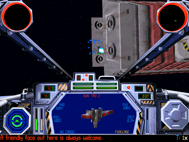

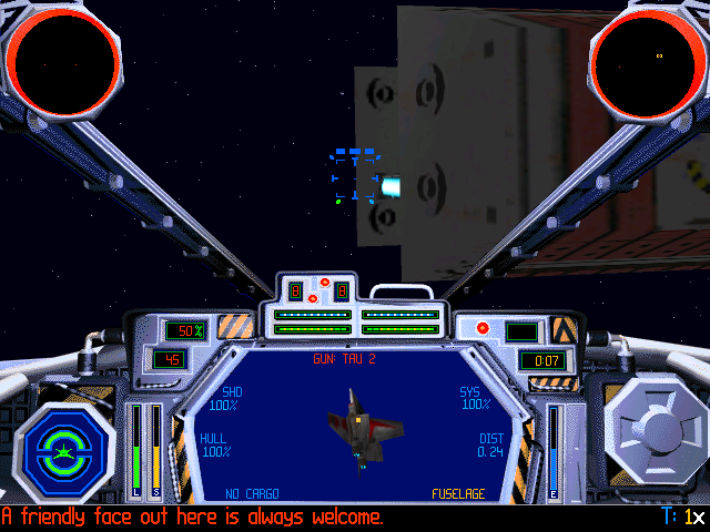

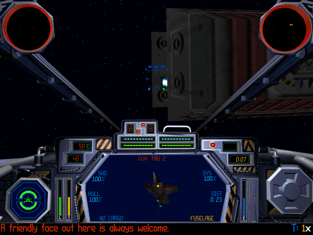

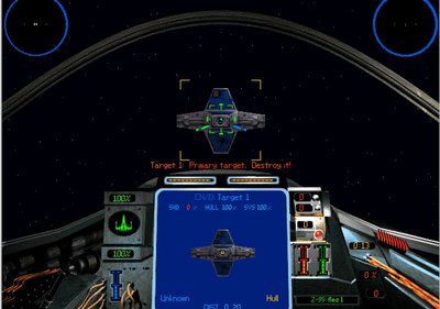

Reply 1 of 53, by gerwin
Made matching comparison images of the rendering modes in TIE Fighter for Windows 95:
156.17 KiB
18405 views
TIE95 SoftWare 3D (16-bit)
142.38 KiB
18405 views
TIE95 HardWare 3D (2x FSAA)
145.81 KiB
18371 views
TIE95 HardWare 3D (2x FSAA) Brightness Zero in the game options
My thanks to Tarvis for the tip about the brightness setting, as written below.
Reply 2 of 53, by Tarvis
Don't forget to set the brightness all the way down in the options, that's what makes the textures look so washed out in the 3D accelerated mode! It does brightness by making the textures brighter, which looks terrible, instead of making the lighting brighter.
Reply 4 of 53, by gerwin
Thanks Tarvis. I added another screenshot to illustrate your point.

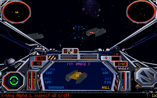

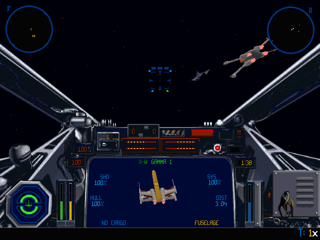

28.77 KiB
17910 views
Screenshot TIE Fighter CD showing X-Wing Cockpit 640x480
15.16 KiB
17820 views
Screenshot TIE Fighter CD showing X-Wing Cockpit 320x200

Reply 10 of 53, by Tarvis
