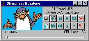

AY-3-8910/YM2149 would be awesome. I remember listening to them on STSound
9.61 KiB
1856 views
and finding them so good that I would start to collect them. This would represent my awaking to a world of FM music outside the Adlib's YM3812. Thinking it was close the the SN76489, I secretly did try to play them with SBVGM without too much conviction and of course it failed.
Although I wonder the implication of converting .YM to .VGM files since it seem to be the core of the Atari musics.
