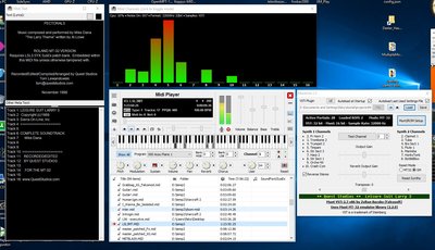

Reply 790 of 1419, by brad86
Yeah, I meant something that can work with the plugin and MidiPlayer to show information like the original MT-32 would do.
Some game will show the song title or other game information on the display and I always found it pretty cool.
Would look something like this...

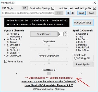

Yeah, I meant something that can work with the plugin.
OK, then the solution of the puzzle seems to be number 2 😀.
As I have said all that information is already displayed by the plugin, only differently in a more readable form:
75.04 KiB
1230 views
By the way the original LCD is only capable of displaying so many characters at once:
7.48 KiB
1230 views
@Edit:
As I have said above it cannot be a a new MidiPlayer display per se since Midiplayer does not have the necessary information. It has to be connected to Munt VSTi and in case of VSTi plugins multiple dialog boxes/editor windows are not the best choices. So the best place to display such information is still inside the existing editor window of Munt VSTi. To give it more emphasis I have thought about something like this:
366.94 KiB
1226 views
