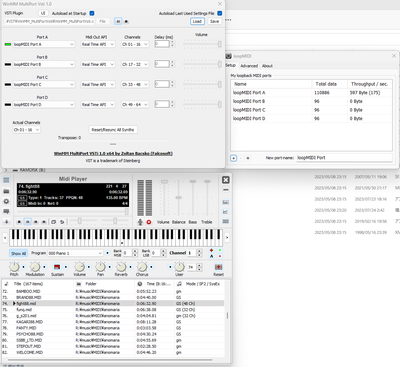

Thanks very much! It works with port A and port B correctly!

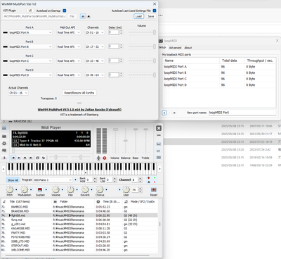

But I found another issue, some MIDI files are detected 32ch or 48ch from FSMP but it doesn't use Port B(Ch 17-32) or Port C(Ch 33-48), used only Port A.
This issue is appeared stable version (6.1.1) too.
for example, this MIDI file is fight88.mid, Title is 'A Fighting Girl', composed by Anomaria from Japan.
Before playing, all ports received reset signal, and after playing, only port A received MIDI signal.
    110.19 KiB
    2210 views
    103.52 KiB
    2210 views
    fight88.zip
    26.97 KiB
    60 downloads
Reply 1481 of 1746, by Falcosoft
basic wrote on 2023-07-23, 18:12:
Thanks very much! It works with port A and port B correctly! […]
Falcosoft wrote on 2023-07-23, 16:28:
OK, I have added support for these types of port select markers. Unfortunately they are simple text events with the format 'Axx' […]
basic wrote on 2023-07-23, 14:25:
I found other issue about a 32ch MIDI file, '26orchst.mid' from SC-8820 demo files. This doesn't work 32ch with current version […]
This doesn't work 32ch with current version of FSMP.
But I found this midi works 32ch correctly with an another MIDI player supports 2-port, It's Miyap2002.
This player supports RCP/R36/G18/G36 with GSD/CM6, RCP/R36/G18/G36 is another MIDI format those was created with PC-98.
I hope FSMP can detect 26orchst.mid to 32ch mode, and similar types too.
OK, I have added support for these types of port select markers. Unfortunately they are simple text events with the format 'Axx' and Bxx' where xx is the channel number and A/B designate the port. So in this case the chances of false positives are higher than in case of previous markers.
Please, test it and report back:
https://falcosoft.hu/midiplayer_62_test.zip
It's because the above Midi file contains explicit port select 2 meta events on 20(!) tracks (port 0 = channels 1-16, port 1 = channels 17-32, port 2 = channels 33-48). Actually port select meta event is the only well defined method for selecting ports (this event is part of the Midi specification). All the other methods (e.g. intended port coded into track name) are just unfortunate hacks.
It's another question that the file then never sends note events on the given tracks. It's a hard decision what we should consider to be multi-port Midi files. Only the ones that really send note events on the designated tracks?
@Edit:
OK, I have added a check so only that tracks are considered "real" in multi-port calculation that contain at least one note event.
Download location is the same.

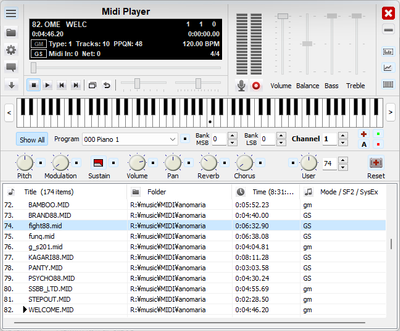

Reply 1482 of 1746, by basic
Falcosoft wrote on 2023-07-23, 18:31:
It's because the above Midi file contains explicit port select 2 meta events on 20(!) tracks (port 0 = channels 1-16, port 1 = c […]
@Edit:
Thanks for fixing it.
Downloaded new test file and launched again, no problem in my MIDI files currently 😀
    48.39 KiB
    2181 views

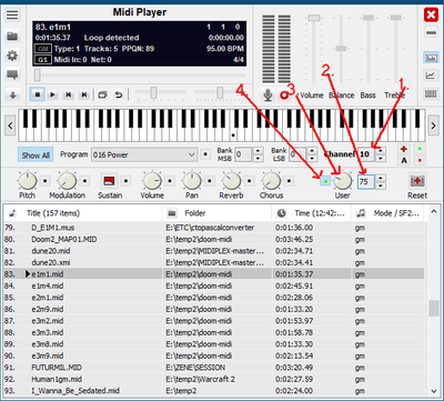

Hi Falcosoft. Does your VST host support patching the SC-VA SC-55 mode to do the cymbal choke on DOOM's E1M1 and DOOM2's MAP01? I would really not like to resort to buying a hardware unit for the accurate sound. Thank you.
Reply 1487 of 1746, by Falcosoft
Abu Brandino wrote on 2023-08-03, 15:24:
Hi,
No, it does not and unfortunately I do not think this is even possible.
At least I do not know any methods currently that make this possible.
SC-VA simply has no such mode or compatibility map that produces the same drum handling quirks as the SC-55.
@Edit:
To emulate this SC-55 drum behaviour on SC-VA you can try the following:
Select channel 10 on FSMP's interface. Then set the 'User' controller number to 75. Then set the knob to value 32. You can also set the 'Force manual mode' toggle to on state. This way I could get a similar effect at the beginning of Doom E1M1.
Unfortunately this controller value influences all the drum notes on Channel 10 not just the needed ones so it's not perfect. Actually this is rather a hack not a solution.

For the ones who want to try it here is a modified Doom E1M1 Midi file that emulates the SC-55 drum cymbal sound on SV-VA properly. This also works on S-YXG50 that also has the same problem with SC-55 cymbal behaviour in GM/XG mode (in GS mode it emulates the SC-55 cymbal sound properly). This works better than the real-time controller modification since the modified controller value is only applied to the problematic section.
Doom_E1M1_SCVA_fixed.zip
6.62 KiB
76 downloads

No, as I said above there is no automatic fix possible. If you set CC#75 controller value to fixed 24 on channel 10 then it affects all drums sounds and some of them will be affected negatively. So CC#75 only works when you place it right before problematic sections and set CC# 75 to default(64) when the problematic section is over. This cannot be done "generally" this process can only work by examining and correcting every affected Midi file.

Reply 1494 of 1746, by Abu Brandino
Falcosoft wrote on 2023-08-05, 13:32:
Abu Brandino wrote on 2023-08-05, 13:02:
...Did your most recent update to your midi player add the fixes or no?
Fair enough then. I will try to get in contact with Roland about it. (I also edited my first comment regarding your MIDIs).
Reply 1495 of 1746, by Falcosoft
The issue with your fixed MIDI files is that they leave SysEx coding that makes the original MIDIs of the WADs play up until a GS RESET is performed. I wish there was better solution.
Only the Doom2 Map01 Midi file contains SysEx messages ( Doom E1M1 does not contain any SysEx messages) . And the SysEx messages are NOT necessary for the drum sound fix. They are only necessary for the improved guitars. So actually all SysEx messages can be removed and the drum fix would still work.
Here is the version without any SysEx messages:
Doom2_MAP01_SCVA_fixed_NoSysEx.zip
4.75 KiB
85 downloads
