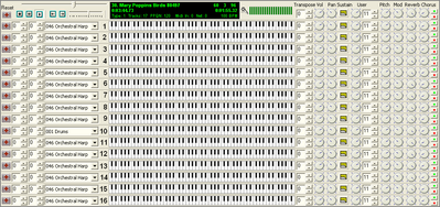

Hello Zoltan,
I've been a member of Vogons for a while now, and I also have been using your MIDIPlayer for many years, it is a great program! I've always been interested in MIDI since the mid 90's when I learned about it. I'm by no means an expert but I do know the general terms, and have many cables and hardware, AWE32 cards etc. I just found a free digital piano with MIDI to plug into my SB Live! card, something I've always wanted to do, play music into the computer, as I play the piano pretty well. The lady says it needs a small fix, but might be easy, so wish me luck on that.
Anyway, back to your player. After using dozens over the years, I've settled on yours for just about everything. It is small, fast, flexible, easy to change MIDI file settings, reverb etc on the fly, and does everything in one program that a whole slew of others could only guess at. I also love your Reality soundfont, it sounds terrific with my Live! Platinum SoundFont card.
There is one feature I've been looking for for years, never found a player that could do it. Yours comes close, it is very flexible, but what would really make my day is to have that flexibility shown for all 16 tracks at once, with little keyboards, that would be fantastic. A year or two ago I hashed up a concept in Windows Paintbrush (been using it since Win 3.1, does my skill show?... 😎 It is several versions out of date, you have done a lot of work since then, and I skipped a few buttons out of laziness, but I think you can get the idea.
I'm not sure how much programming that would take, I've done DOS Batch files in the past but never learned a programming language. Perhaps something like putting in an "Expand" button that would duplicate your player 16 times for the 16 tracks? The knobs at the top-R would be Master control knobs, and turn all the others at once. I love to turn up the Reverb on all tracks in my MIDI files all the time, so this is one of my main likes about this setup, not having to do it for each track 16 times.
Anyway, this would be a really great thing to have, and I can understand if it would be too much work, but thought I'd throw it out there for you to see. Glad I found this forum, it's great having a place to hash out ideas like this.... 😀
All the best Zoltan, and MANY thanks for a GREAT EXCELLENT program AND soundfont I use everyday!
Bellarmine

Reply 222 of 1727, by Falcosoft
Hi,
Thanks for your feedback.
You are not the first one who suggests this feature, but to tell you the truth it's not likely it will be implemented in the near future.
I must say your skill DOES show, and you are the first who can come up with a plausible concept (I could not). But it also seems a little crowded. But making more spaces would require a vertical dual monitor setup, so it's not so easy to make it right. (And this whole concept resembles a complete full screen sequencer/rack solution rather than a player).
But it stays on the wish list anyway.
For the time being you can try other solutions in chain with FSMP. E.g. http://openmidiproject.osdn.jp/MIDITester_en.html looks much like your concept.
@Edit:I hardly dare to say it since I'm almost sure you have already found it, but who knows. The channel selector up/down has a right click context menu that can help switching channels.
@I have seen in 'SoundBlaster AWE64 Gold SPDIF Clarification' topic that you have/had a problem installing Creative WaveSynth/WG on non-intel CPUs. Instead of what the referred article suggests (implementing the whole dll functionality) a more simple solution is to hack 1 byte (JZ/JNZ -> JMP) in the original dll in the function that checks for GenuineIntel and always return true. I have made it many times.

Reply 230 of 1727, by bellarmine
Falcosoft wrote:
Hi, Thanks for your feedback. You are not the first one who suggests this feature, but to tell you the truth it's not likely it […]
Hi,
I must say your skill DOES show, and you are the first who can come up with a plausible concept (I could ....................
Hello Zoltan,
Sorry for the delay, I wanted to say thanks very much for your compliments on my "Deluxe Mixer" concept, I'm flattered to be the first to have a 'workable' concept, it means a lot to me!
Thank you for the link to the OpenMIDIProject, it looks very interesting. I downloaded it and will check it out.
Also, no I did NOT know about the R-click channel selector, you even show the lables too! You keep cramming more and more little doo-dads and features into your compact player, I like that. One great thing you added recently is the little graphics display for the 16 channels. I was REALLY missing that, if I had to choose a feature from my 'Deluxe' mixer concept for you to implement, that would have been my choice, so thanks for that!
I will tell you what I do to select channels in FSMP more easily - I use a small piece of software called KatMouse:
http://ehiti.de/katmouse/
It does the standard mouse focus thing, where the scroll wheel works on what the pointer is over, not what app is active. Anyway, when the mouse pointer is over the channel list I can simply scroll it with the scroll wheel, VERY fast. Also, I can pretty easily turn up the Reverb on ALL channels by this simple procedure: Click on the Reverb knob; press and hold END on the keyboard (max Reverb); then while holding down END, scroll the wheel over the channel list - once it loops back to channel 1, ALL channels have max reverb - pretty easy.
Finally, that's interesting what you said about the SoundBlaster WaveSynth - I'd be interested in learning your method. I did manage to install the suite using another method, but came up with another problem: After installation and rebooting, the WaveSynth driver simply refuses to load without a Pentium chip - so I guess fixing the Install routine isn't the end of it. If you know different DO let me know.
Bellarmine

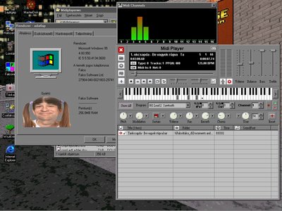

Reply 236 of 1727, by Falcosoft
Well, to tell you the truth under "Win9x" I meant Win98, SE and ME. I have not tested it under Win95. But I have just tried it on my old Win95(A) virtual machine and it started without problems (just some font problems can be detected). So I suggest that you should install the latest directx available for Win95 (I think it's directx8) since bass libraries and recording need it.
Used hardware (sound card) and available Midi out devices?
305.76 KiB
2506 views
Website, Facebook, Youtube

Reply 237 of 1727, by elianda
Ok I think that is the problem here. DirectX8 requires a Pentium class CPU and does not install on an older CPUs. Win95 itself runs on 386+.
So maybe extend the details for the requirements in the first post to DirectX8 + Pentium.

Reply 238 of 1727, by Falcosoft
Actually it also works with Directx 6/7 but definitely requires a Pentium class CPU. There are hand-made assembly routines in the code that use RDTSC and the compiler is also set to generate Pentium optimized code.
Yes, you are right. Pentium requirement is added to first post.
@Edit:
The biggest problem is that unlike the Pentium, the NexGen 586 has no built-in math co-processor(FPU). So even a new compile and removed asm could not help.
