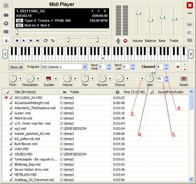

Me: Ok, I think I have found the problem. ScummVM/Larry6 sets CC#75 to 0 on all channels. This controller is undefined in GM, bu […]
Me:
Ok, I think I have found the problem. ScummVM/Larry6 sets CC#75 to 0 on all channels. This controller is undefined in GM, but on GS devices it controls 'decay time' and its default is 64. So you should filter Controller 75 or set it to default 64 after larry/scummvm sets it to 0.
If you use FSMP:
1. Enable Main menu-> compatibility settings->'apply controls to midi in'
2. Select channel 10.
3. Set the 'User' controller number to 75.
4. Set it to 64, or press a reset.
5. Press the little 'force manul mode' button beside the 'User' controller.
6. Repeat 2-5 on all channels where you experience this cutoff effect.

Reply 505 of 1727, by KainXVIII
Me:
If you use FSMP:
I have problems with 6 step, how do i know which channel is cut off? I'm not an expert =)
Reply 506 of 1727, by Falcosoft
You do not have to be an expert you will hear it if there is a problem. 😀 And you can see that the knobs are set to 0 position (leftmost) instead of 64 (middle) on problematic channels. The most problematic/audible is channel 10 (drums).
But to be sure you can do it on all channels (Actually you only have to do step 5. on each channel after you have done all steps once).

Reply 508 of 1727, by Falcosoft
Directly with Channel selector Up/Down control, or with the right click popup menu of the control. I don't really believe you have never used it. It's bold and says Channel 😀
The numbers correspond the list above:
