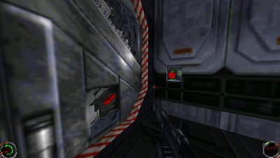

Reply 187 of 892, by blam666
Here are two screenshots of this "invisibility" problem, one with vanilla JK1, one with enhanced. I will post two more soon (were too big to upload right now).

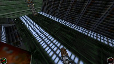

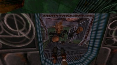

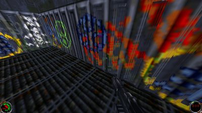

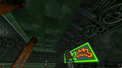

Reply 188 of 892, by blam666
And even more snaps of the glitchy bugs. The smearing isn't that easy to demonstrate in a still picture, but I think you get the idea.
Checking or uncheciking the z blits box didn't really change anything, as far as I can tell by now.

Reply 191 of 892, by Peixoto
milepanic wrote:
So I tried new version of patch on Tomb Raider III, vertical line fix is working, but I have problem with sound. When games go into title menu or in-game sound disappear. When I try your patch with Arsunt widescreen FMV fix patch sound works but game crashes in title menu, same happens when "Disable widescreen and transparent inventory background For those using Arsunt's exe " is checked. Any thoughts what could it be? MP4 FMV still not working.
thanks
That option only affects TRII, but i can be added to TRIII as well. I don't plan to support arsunt's exe right now however, it only disables thinks that are version specific and 'm not doing any testing with arsunt's exe.
Regarding the other issues: you are using steam right? have you installed the mutipatch? I don't have the steam version, so...

blam666 wrote:
Ok, the graphical glitches sadly are still there, even with the new option checked or unchecked. […]
But I found out more about the GOG version problems. Unofficial exe was already there and exchanged. But here are the new facts: Gog version refused to start when I had the folder and exe in (something like) D:/Games/Jedi Knight. I had the idea to move it and changed the path to C:/Jedi Knight. And suddenly it works. Patch starts up the gog version. So gog vs. works but has some weird path allocation bug.
I'm a little confused by this. But I rechecked just this minute. I copied the exactly same folder to root c and it started, I tried back in non-root d partition/folder and it didn't start. I don't what's going on here. But all things considered, Gog version works with the patch!
I will provide some screenshots of the graphical glitches soon.
Strange bug indeed, does if affects the Disk version as well? By the way, i've done some change in the installer, the unofficial patch for MotS will now work
Reply 193 of 892, by blam666
Yes, affects all versions unfortunately. I wouldn't even care about the GOG version. Your patch would give me the possibility of lossless soundtrack, GOG just accepts ogg.
I know the dgvoodoo wraps the game on my pc without these problems. But as I wrote before, it gives me screen tearing in the fmvs when I use the pre-patched exe for installing mods.

Reply 196 of 892, by Peixoto
blam666 wrote:
Still the same path trouble with the updated patch. Actually, it didn't have any problems before with the patched exe per se. It really seems to have problems with certain paths. I have one folder in c root of the game which starts fine with the patch. I just copied it to d root and it refused to start. Can there be something in the installer script which fixes the execution to the system folder / c:\?
I don't have any special security settings for my d partition as far as I know. I know sometimes there can be problems with c:\Program Files path etc. because of Windows restrictions, but root and /Games usually work fine for any old games.
On the latest version, the installer actually removes all registry entries for both games, because in my system with or without the patch, they only cause trouble, and the games run fine if everything from the CD in correctly installed.
Can you try the following experiment?
Create an ini file in the scripts folder with the following:
D3D=1
32bit=True
HD=True
MHKS=True
MCI=True
Compatlayer=win95
Restart help.exe and you will see a new entry with the name of the new ini file
Start the game form that entry, select the highest resolution in the display menu and lets see if the graphics glitch is solved
If it is solved, we can start narrowing down what causes that glitch
Reply 197 of 892, by blam666
Ok, created JEDITEST.INI with the 6 lines you wrote and nothing else in a fresh re-download of the newest update of the patch. Started the new ini.
A folder with the game without any ddraw.dll and with the pre-patched version in d/root again didn't start.
A folder in c/root with the same content did start the JEDITEST.INI. Game had the same graphical glitches as before, the fov was changed to normal of course.
Re-copied the folder that just started to d/root to be certain to be certain about the path bug, again didn't start.
To investigate a little further i created a new folder of the unpatched version of the game in c root. It did start but the menu wasn't electable, the mouse couldn't click anything.
