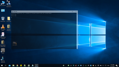

Hello Peixoto.
I'm having problems running your patch with both Little Big Adventure 1 and Little Big Adventure 2.
Windows 10
LBA1:
The game will start after the injector does its thing, but then I will get a cropped window in the top left corner of my computer with a black screen. The error code doesn't show anything failed. I tried searching the web for info on this, but couldn't find anything. I'm also running the games from my old CDROM copies of the games (NOT the GOG), using LBAWIN0.81.
Peixotos's patch remote settings:
32bit: 1
_macros: up,down,left,right,enter,esc,w,alt,ctrl,space,h,shift,F5,F6
D3D: 1
D3D_Driver: C:\WINDOWS\System32\DriverStore\FileRepository\nvdmi.inf_amd64_774120bbcad3ef2b\nvldumd.dll
deadzone: 0.25
dsk: 1920x1080
dsound: 1
error_log: C:\Program Files (x86)\LbaWin\error.log
hd: 1
HDPI: 1
injector_dir: C:\Program Files (x86)\LbaWin
max_4x3_res: 1400x1050
MCI: 1
Mydocs: C:\Users\David Wilamart\Documents
os_version: 10.000000
path: C:\Users\David Wilamart\Documents\Games\Little Big Adventure\LbaWin\
resolutions_list: 320x200 320x240 400x300 512x384 640x400 640x480 800x600 1024x768 1152x864 1280x600 1280x720 1280x768 1280x800 1280x960 1280x1024 1360x768 1366x768 1400x1050 1440x900 1600x900 1680x1050 1920x1080
sclr: 1
script: scripts\lba.ahk
script_hwnd: 0x7e0e08
singlecore: 1
target: C:\Program Files (x86)\LbaWin\LbaWin.exe
target_dir: C:\Program Files (x86)\LbaWin
target_name: LbaWin.exe
usemacros: 1
XBR: 1
CreateProcessA Hook: 0
CreateProcessW Hook: 0
mciSendCommand hook 0
mciSendString hook 0
auxOutSetVolume hook 0

LBA2:
It doesn't seem to launch the injector. Just get a quick message about:
"Changing compatibility for C:\Dosbox-0.74\Games\LBA2EU\LBA2.EXE HIGHDPIAWARE
hProc 824
hProc 824"
then it closes. I had to quickly do a screen capture to see it.
I appreciate your work and your help!
-David

LBA2:
hProc 824
hProc 824"
-David
