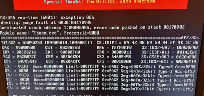

Is someone currently using fdoom successfully with an Interwave based card (GUS pnp, ARGUS, etc.)?
I think it was working at some point (not completely sure, though), but I'm currently unable to get it to work at all. Everytime I choose the Gravis ultrasound for FX and music, it doesn't play anything (no error on startup) and throws an exception after quitting:
The attachment signal-2023-01-27-173709_002.jpeg is no longer available
I've tried running it with a standard config and without anything loading on startup (Shift during bootup).
I've tried flipping almost all BIOS settings.
I've swapped this clone card to an ARGUS and a real Gravis PnP.
I've changed to another system (486DX2-66 to PII-400).
I've also gone back to releases in the 0.8 and 0.7 range.
Every time it won't play anything and give the above exception on quitting. Changing to a Soundblaster or using Midi music works - even them being on the same physical card as the not working Interwave.

What IRQ is your GUS on? My GUSpnp has always been on 11 and FastDOOM doesn’t like that. If you have UNISOUND on your system, you can try set your GUSpnp to IRQ 7 by doing the following:
SET ULTRASND=port,dma,dma,7,7 (the first 3 values you should copy from your AUTOEXEC.BAT)
UNISOUND
On my system IRQ 7 is free (in DOS, when I don’t use the parallel port) and then it works.
This is a limitation of the Apogee Sound System (FastDOOM uses it) which doesn't allow using IRQ higher than 7 no matter which DOS extender is used to run. Additionally, versions of DOS/32A after 7.35 tend to crash when a device attempts to use such higher IRQs on a real computer.

digistorm and Gmbl256, I bow to you both and want to thank you for this quick and perfectly directed pointer! Of course, the IRQ was set to 11 and changing it did help instantly.
For some reason, since it's always been set to that known free IRQ in my systems since the stone age, I didn't even consider looking there, even though it also directly explains why the PicoGUS does work (since it's only an 8bit slot card).
