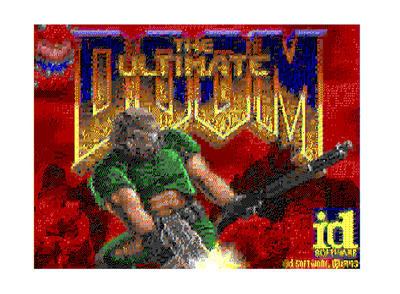

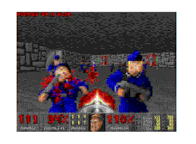

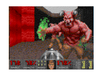

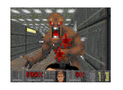

Doom CGA? Let's see what CGAArt makes of it:
    358.53 KiB
    3121 views
    Doom 1 E1M9
    365.37 KiB
    3121 views
    Doom 1 title screen

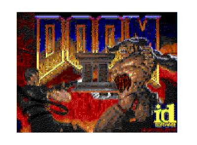

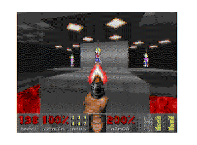

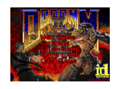

Reply 144 of 987, by Calvero
And Doom II:
    356.03 KiB
    3118 views
    360.41 KiB
    3118 views
    246.42 KiB
    3118 views
    270.84 KiB
    3118 views
    379.01 KiB
    3118 views

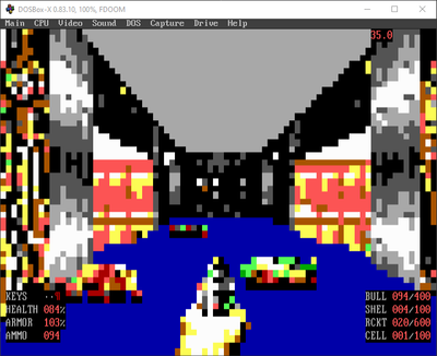

Reply 155 of 987, by ViTi95
It's possible to use the shade characters for the VGA 80x50 mode, and apply that only to the sprites. That would make them look different and a bit easier to see. It's also doable for the 80x25 CGA and EGA modes, but the 80x25 resolution it's way to low for the sprites, the more vertical resolution, the better. This weekend I will release a test executable so people can test it and give feedback.
Edit: A little update, a basic status bar is now implemented 😁
