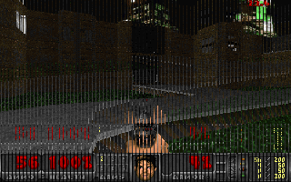

Reply 171 of 987, by MrFlibble
ViTi95 wrote on 2021-04-13, 23:09:
@MrFlibble I will check that bug, and see if i can correct it for a bugfix release.
Thanks!
UPD: I can report that the demos in the Phase 1 IWAD (the Ultimate Doom counterpart; I'm testing the version from here) work fine. Maybe it's a feature of the map where the Phase 2 demo was recorded, not complying with vanilla standards.
UPD2: Yep, it's definitely the map (MAP15). I just warped there and here's what I got in the same area where the demo would freeze:
