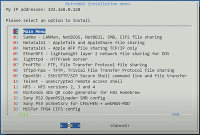

What is it? A set of open source tools for your Raspberry Pi or other Linux box, enabling you to set up a NAS for your retro machines with a single installer, complete with slick menu system. It makes all of these tools very simple and accessible for regular folk, like me.
155.8 KiB
6491 views
So far it supports the following:
  • MS-DOS and clones such as PC-DOS and FreeDOS
  • Microsoft Windows 95 and up
  • Apple GS/OS, Classic Mac System 6 and System 7
  • Apple Mac OS8, OS9, OS X 10.0 and up
  • Atari ST with FTP client or HTTP browser
  • Amiga Workbench 3.X and up with FTP client or HTTP browser
  • Nintendo 3DS with Homebrew Channel and FBI installer
  • Sony PlayStation 2 with OpenPS2Loader
  • Sony PlayStation 3 with CFW/HEN and webMAN-MOD
  • Microsoft XBox 360 with JTAG/RGH, custom dash and ConnectX plugin
  • MiSTer FPGA

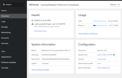

I've been running it on a Pi 4, serving up my library to my DOS, 9x and XP machines. No more physical media for file transfers. In many cases I can even just run software or mount ISOs straight off the network share. It's changed the game to the point where even slinging a CF card around feels like work now. I manage my library from my modern rig, and it's right there ready to go when I fire up a retro rig. Samba is the main workhorse for me, but I also run EtherDFS for the DOS machine, and do a little FTP and Telnet on the side. I'm also using GOGrepo to sync my GOG library straight to the NAS. And Cockpit, which allows me to manage settings from a modern web browser.
80.33 KiB
6491 views
If you have the knowledge and skill you might have been using a bunch of these tools already. What Dan has done here is make them extremely accessible to everyone. I love the pants off this project, and just wanted to share it now that it's gone live.
If you have a later model Pi sitting around (or an existing NAS, old laptop or even a VM) it's worth taking for a spin.
