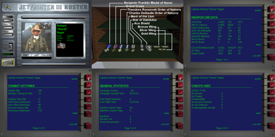

Reply 3 of 3, by rfnagel
I finally completed ALL of the campaigns in JetFighter III Platinum Edition, and here are my final statistics. I completed a total of 125 sorties over the course of 6 different campaigns (not including the initial flight training missions), and have over 54 hours of mission flight time.
610.72 KiB
