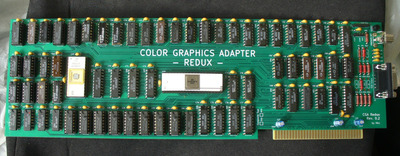

Hi there, when i tried fdoomc16 on newly made CGA (CGA Redux) i got a lot of "cga snow" unfortunately...
Sorry for offtopic

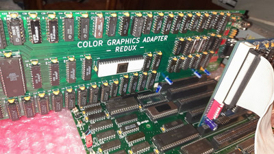

Reply 28 of 53, by Tronix
root42 wrote on 2022-08-22, 12:06:
Is that snow static, or does it flicker? A small video might be nice.
Something like this: https://youtu.be/0ivcM-2TK4w
Also: where die you get the CGA Redux card from? Looks neat! Would love to build something like that!
CGA Redux is open source project found here: https://github.com/hkzlab/CGA_Redux ,
so there are "gerber" files necessary for the production of PCB and everyone, if desired, can order their production at any PCB factory. We got together as a small Russian community and ordered around 10 PCB boards from a JLCPCB factory in China.

Reply 30 of 53, by root42
Tronix wrote on 2022-08-22, 12:22:
Ah yes. My guess would be that the Video RAM is updated while the card is displaying. I think this is a no-no with old CGA cards, and the CGA Redux should fall into that category. My guess would be this has to be fixed on the side of Fast DOOM.

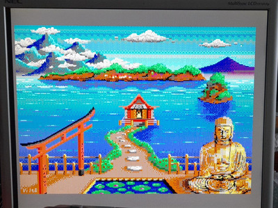

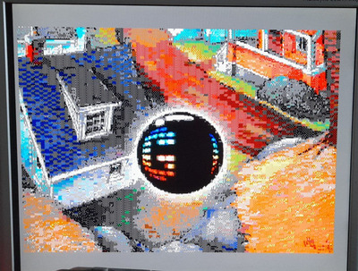

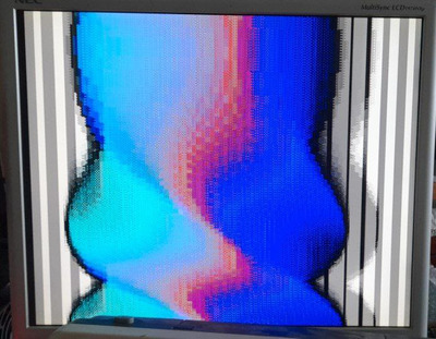

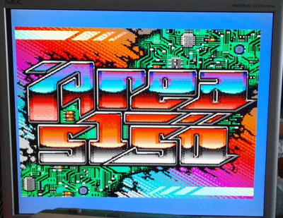

VileR wrote on 2022-08-22, 16:42:
So how does 'CGA Redux' deal with this demo?
if the question is for me, then i can't say exactly. I don't have a real 5150, I just have different kinds of XT-clones motherboards. I also do not have a real CGA monitor,so to display the image from CGA i use the MCE2VGA converter. I tried to run the demo on a "regular" XT 4.7MHz clone and it works fine in my opinion, except for the final part with image stretching and titles (greetings) - there seems to be a frame breakdown and i don’t know who is to blame - the MCE2VGA converter or CGA Redux or the motherboard. in any case, everything else in the demo works fine.
I would like to take this opportunity to say thank you for a great demo.

Reply 34 of 53, by reenigne
If the CGA Redux uses essentially the same circuit as the IBM CGA (particularly in regards to wait states) and has an MC6845 then the reason it fails to show the wibble and lake effects at the end is bound to be due to the motherboard - the timing needed to get all the CRTC writes in the right place is very precise and if the inner loop doesn't take exactly 304 cycles per iteration then it'll all fall apart.
