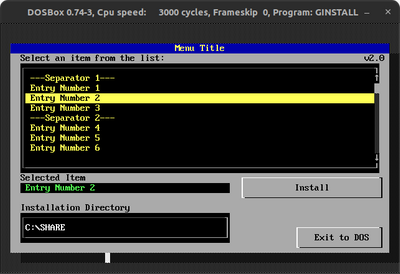

Some (long) time ago I created a small menu application to install multiple DOS programs from a distribution media (i.e. CD) to the user's hard drive. The main idea behind it was to create compilation CDs with DOS shareware/freeware titles. Since it was released, some users got in touch asking for features like being able to change colors or be able to add sound to the menu. Now I'm releasing version 2.0 of it, and also gave it a name... GINSTALL.

Some key differences from the previous version:
-Colors can be customized
-Support for PC Speaker sounds (the sounds can be customized, too)
Hope this is useful for some people...Here is how it works (taken from the readme file):

2.1- Adding items to the installer:
As already mentioned, everything in the installer is defined through configuration files inside the CFG sub-directory. All menu items are loaded from APPLIST.CFG file and its structure is quite simple: Odd lines contain the name of the zip file to be extracted while even lines
contain the text that will be displayed in the menu.
For instance, if you want to create a menu to install some shareware games, the APPLIST.CFG file would look like this:
DOOM
Doom Shareware
HERETIC
Heretic Shareware
DUKE3D
Duke Nukem 3D Shareware
That means the menu will display three entries for the user to pick:
Doom Shareware
Heretic Shareware
If the user selects Doom Shareware, then the program will attempt to extract the contents of ZIPFILES\DOOM.ZIP to a subfolder named DOOM inside the defined installation directory. Considering the default installation directory is defined as C:\SHARE, then all contents of
DOOM.ZIP would be extracted to C:\SHARE\DOOM. The default installation directory can be changed in STRINGS.CFG file (covered under the Customizing Text section) and also at runtime by the user.

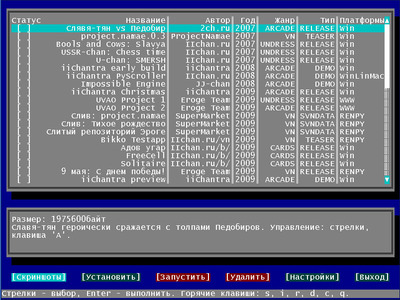

Reply 5 of 7, by VKRadeon
I see. Well, will try to remake this menu. Some guy made it on renpy. Cool thing, but only zip as archive format

Reply 6 of 7, by gaffa2002
Hey, that looks nice. Never thought about using a text user interface in newer OSes, please let me know once you finish as I'd love to replace my script for something like that.

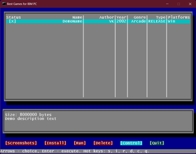

Reply 7 of 7, by VKRadeon
As I'm newbie, I cannot DM you, so I'll post here
Here is link to this programm. Translated into English.
Originally I found this programm here. It looks most exaclty like install base on old Russian warez cds from REMOVED. Supports screenshots, btw. Tried to contact the author, but no response. So, I've decompiled it, removed all anime related stuff and translated it. Supports web games, linux games and renpy games. File BASE.TXT is game base (base.org is a text file with original list of games). First 2 columns are archive name and folder where to find it. Supports only zip archives. Screenshots must be with and named as archive file, with _1.png, _2.png and etc. Starting logo is cf.bmp file. 800*600. Replace with anythig. Program caption is in game\options.rpy, everything else is in game\script.rpy.
Later I want to remove Linux, MAC and other unneeded stuff and will try to make it start external unpacker instead of internal zip. So far it is all there. If you'll find a way to add RAR archive unpacking, please share it with me.
