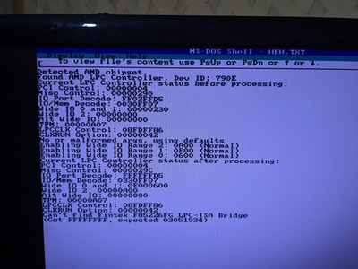

Reply 182 of 518, by LSS10999
rasteri wrote on 2023-08-08, 11:59:
LSS10999 wrote on 2023-08-08, 00:56:
Does your test board (A320M-K) also have the TPM selection toggle? The one that allows choosing whether to use a discrete or built-in (firmware) TPM.
Yeah I believe it does but I haven't messed with it yet - will have some time soon.
I've attached the output of your program if that helps.
Except the PCI control register the rest of your board's initial register states are the same as mine. In your case (0x4), the only bit set was enabling legacy DMA. Mine also had two ROM-sharing related bits set, making it 0x1C.
With IO/Mem decode register's initial state being like that... you should already be able to access 4E/4F. All LPCEXP did to that register was enabling the other two Wide I/O ranges (which were disabled and initially set to zero).

Reply 184 of 518, by rasteri
LSS10999 wrote on 2023-08-08, 16:01:
The new boards arrived, and are working great on intel.
On AMD I'm getting the same error as before.
Curiously however, if I put an ISA test card in, it shows BIOS POST codes and anything else that gets sent to I/O port 0x80. This means the LPC bus and Fintek bridge must be working, just (presumably) not for ports 4E/4F.
I wonder if there's another device hogging those addresses, or if something else must be done to route them to the LPC bus.

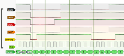

Looks like the motherboard is sending on 4E and reading from 4F, but the fintek chip isn't responding. I wonder if there's something unusual about the packet format the motherboard is sending, or if there's bus contention or something (caused by super I/O?)
I'll have to analyze a working Intel motherboard so I know what a healthy sequence looks like.

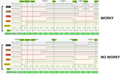

Reply 191 of 518, by rasteri
I was wrong, the AMD motherboard (NO WORKY) is aborting the 0x4F read (i.e. asserting LFRAME) halfway through the cycle. I wonder why it would do that, and if it's the same for all addresses or just 4F...
I wonder if this is some subtractive decoding weirdness

On further investigation the LPC aborting occurs on a port-by-port basis. Port 2F doesn't abort, but port 4F does.
I wonder if we're missing a register somewhere that enables 4F to be passed to the LPC bus. Or perhaps a PCI device is claiming 4F through subtractive decoding?
I have logic traces of boots with and without fTPM, I'll analyze them later
