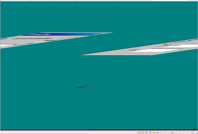

Games testing:
- im using Fraps for FPS monitoring..
Conan - Cauldron Demo - Running - graphics fine - 640x480 - 8 FPS - unplayble..
After game exit.. everything broke.. i saw only 640x480 part of 1280x960 desktop so i tried to adjust Vmware window size.. picture fell apart and its broken even after restart.. and i dunno how to fix it:( This is windows login screen..
Even restart of physical machine not helped.. It really does not like that Vmware windows resize, which is build in standard Vmware driver.. i dunno if it could be disable somwhere in *.vmx file etc..
So it needs real Vmware tutorial, more testing and lots of work to claims that its running with Vmware..

It has still some Win9x graphics drivers problem like broken desktop draw after games exits..
