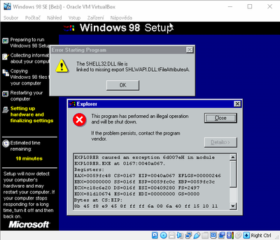

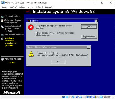

Reply 57 of 155, by LSS10999
RayeR wrote on 2023-06-12, 17:48:
Just a note for those about dark GLQuake problem... Some decade ago I also faced it (no brightness slider work) and found it cou […]
Some decade ago I also faced it (no brightness slider work) and found it could be fixed by some external utility, I hope it was called idGamma, try it out...
https://www.quaketerminus.com/exe.shtml
Otherwise softgpu looks interesting, I have Vbox 7.0.6 at work so I'll try to install W98 VM and play with it a bit...
UPD: damn, I'm unable to install Win98SE under Virtualbox, hangs under setup, after hardreset I got a bunch of errors when copying/registering DLLs and didn't reach to desktop. When installing W98 in the past under VMware I didn't have such problems...
Hm, same with english ISO...
You probably need to use patcher9x. It seems with very recent CPUs that patch is mandatory for running a Win9x VM.

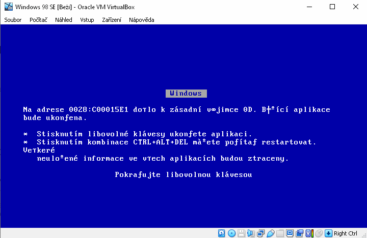

Reply 58 of 155, by RayeR
LSS10999 wrote on 2023-06-13, 00:31:
Aha, thank you for pointing me the right direction. I didn't know about this patch yet (I quickly skipped to VM setup). I run Win98Se native on my Sandybridge i7 @4,5GHz and I didn't needed such patch yet. But this installation is done on much newer Tigerlake i7 (gen. 11) that is explicitly mentioned needing a patch. Well I patched during installation and finally finished the Windows setup. Then I just installed DX9, MSVCRT, and SoftGPU. I selected SSE/AVX option but got crashes and BSODs after restart when driver being active. So I disabled simd95.com and reinstalled with basic options. I got one BSOD after changing resolution from default to 1024x768/32bpp but after reboot it started normally and I was able to run GLchecker and Blender benchmark and got ~45FPS. Later I got BSOD again and the Windows swithced back to 640x480 and hanged at desktop loads. I can boot only in safemode.
Well, as I was unable to recover current installation I made new one. Now I copied install files from ISO to HDD and run patch9x over CAB files. Windows installed OK and seems to be stable untill...
I installed MSVCRT, DX9 and SoftGPU without AVX/SSE (made restart after each component as suggested)
* after 1st restart (after SoftGPU install) system hanged at logon screen - hardreset
* 2nd start - system booted to desktop and immediatelly folowed by BSOD - hardreset
* 3rd start - system booted to desktop and I was able to go to display control panel and set 1024x768/32bpp, system asked for restart and hanged - hardreset
*4th start - system booted to desktop and hanged (mouse cursor moving with permanent hourglass, no reaction to CTRL+ALT+DEL) - hardreset
*5th start - system booted to desktop and hanged (mouse cursor doesn't move with permanent hourglass, no reaction to CTRL+ALT+DEL) - hardreset
*6th start - system booted to desktop and was responsive, I can go again to display control panel where is default 640x480/8bpp, I set 800x600/16bpp and it hanged again when restart required - hardreset
*7th start - system booted to desktop and was responsive after a while, I can go again to display control panel where is default 640x480/8bpp, I set 1024x768/32bpp and set make change without restarting, surprisingly it changed resolution as expected and I could run GLchecker and Blender benchmark (again 45-48FPS)
*8rh restart that I did correctly via Star menu - system booted to desktop (1024x768) and hanged (mouse cursor not moving with permanent hourglass, no reaction to CTRL+ALT+DEL) - hardreset
I'm a bit confused about this random behavior...
