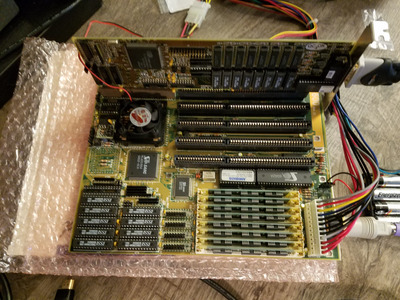

I found a guy selling NOS 486 motherboards from god knows where, that typically wound up auctioning after a few days for $30-50. It was too good an opportunity to resist. I knew I wanted one with VLB, since my father bragging proudly that our family computer had a screaming fast VLB VGA card is among the few details I remember. Had no idea what that even meant back then. Wound up with an Amptron DX-6600, which seems to be an alternate brand for a PCChips M601? Mine appeared to come with some sort of AMD compatibility clock generator preinstalled, so decided to go with an AMD cpu to go with it. Would an Intel still work? I have no clue! The jumpers appeared preconfigured for a 33 Mhz FSB and a DX or DX2 processor.
Motherboard in hand, I rounded it out with 8 MB of 70ns 30-Pin SIMMs, a Cirrus Logic GD5428 VLB card, and the aforementioned AMD DX2.
The attachment 20230918_132042.jpg is no longer available

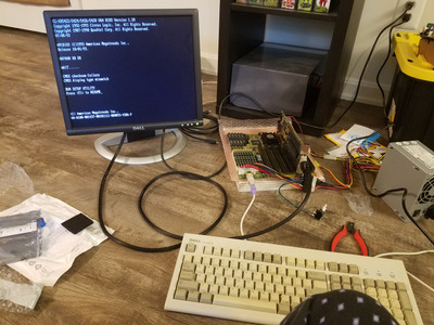

I clipped off the Varta battery which had not yet leaked, and it seemed to POST alright with just the DX2, memory and VGA card installed.
The attachment 20230913_153510.jpg is no longer available

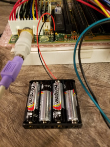

The information available at The Retroweb seemed to indicate it needs a 6V external battery, so I connected a 4 AAA battery case to the appropriate pins, and it appears good.
The attachment 20230918_132403.jpg is no longer available
Properly detects the 66 Mhz processor too.

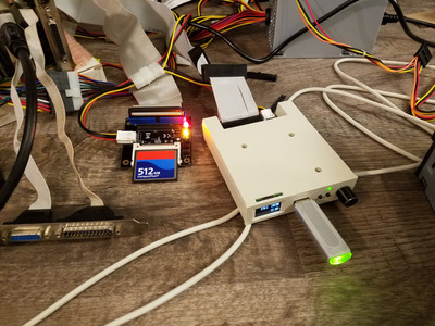

I ordered a Gotek to go with it, and an ES1868 sound card. I already have a compact flash to IDE adapter, and this generic VLB multi IO card, although I haven't tested it yet. We'll see how getting DOS 6.22 installed goes, and then try some benchmarks. I have no expectation of pushing this system to any sort of limits. If I can get some nice average DX2 performance out of it, I'll be more than happy. I have other machines if I want more power.

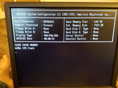

I actually had a surprisingly productive evening. The generic VLB multi io card worked out the gate. My Gotek didn't. I had to make sure either the JC jumper was closed, or the interface was set to ibmpc. That problem solved, I moved onto getting DOS 6.22 installed on the compact flash card.
This also caused a problem, where it appeared to install fine, but then the drive refused to boot into anything. I did a bunch of basic, random stuff to try to narrow things down. Took out some extra memory, turned off all the shadowing and the caches. None of it helped. Then I shuffled a compact flash card from another system which booted just fine, and then tried the new one in the other system where it also failed to boot. So that narrowed it down to the card itself. But, I've had weird issues like this before with drives that had unknown prior states, and after a quick FDISK /MBR it was booting properly into DOS 6.22. Didn't even have to reinstall.

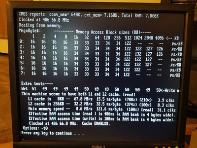

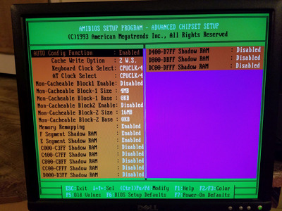

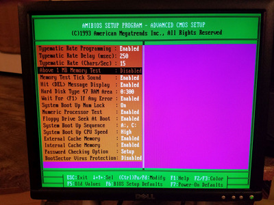

I ran a few benchmarks, and it seems to be underperforming a bit. So I dropped the "Cache Write Option" down to 0 W.S. (YOLO) and seem to be getting 3DBench and Doom FPS closer to what I expected from other system benchmarks. About 41 FPS in 3DBench and 22.5 FPS/3311 realticks in Doom. I think my initial 3DBench result was closer to 32 than 42. No ill effects so far.
There are a smattering of BIOS settings I'm very unfamiliar with however.
The attachment 20230918_220321.jpg is no longer available
The attachment 20230918_220309.jpg is no longer available
I have no clue what "Hard Disk Type 47 RAM Area" could possibly be, nor "Memory Remapping", "F Segment Shadow RAM", "E Segment Shadow RAM" or any of the disabled "Non-Cacheable BlockX" settings.
Reply 3 of 36, by jakethompson1
Namrok wrote on 2023-09-19, 02:41:
I have a copy of Programmer's Guide to the AMIBIOS and have looked at a bunch of these so here goes.
Hard Disk Type 47 RAM Area. The BIOS has to set up a Fixed Disk Parameter Table that holds the C/H/S values among other things. When you use a preset disk type, it also has a bunch of pre-made FDPTs in ROM and sets up a pointer to the ROM. With user-defined types, the table has to be in RAM. The choices are to steal some of the BIOS stack area/ROM BASIC interrupt vectors and use it to store the FDPT, or to steal a KB of conventional memory. The option is disregarded if shadowing is enabled and it can just patch the FDPT into the shadow RAM. The "steal a KB" option is obviously not preferred but I believe it may have been required for OS/2 compatibility for its side effect of reserving some space for 286-to-386 loadall translation (being so random, that's definitely something I remember from the book).
Memory remapping is for memory-scarce systems such as 2MB or 4MB systems and often the chipset can't do it with any more than that. Of the 384KB of RAM you have between 640K and 1024K, 128K is used for shadowing (C000 for video BIOS/SCSI BIOS/etc., F000 for system BIOS) and the other 256K is lost. Memory remapping recovers that 256K by moving it to the top of the address space. It can cause issues if that 256K is beyond your cacheable area, and I had another case where a VLB video driver incorrectly found the top of memory and tried to map the linear framebuffer there. Since we tend to use these systems with plenty of RAM you may want this off.
F segment shadow RAM is copying the system BIOS from slow and narrow ROM to fast and wide (32-bit) RAM, always keep enabled. Same with C000-C7FF shadowing aka "video BIOS shadowing"
E segment would be the same, but only if you have option ROMs there or if the BIOS spills over into there. You would not see this on ISA/VLB systems but possibly an EISA system would have BIOS there.
I can't think of a use of the non-cacheable blocks. It would make sense if the system was otherwise erroneously caching RAM on a VLB card (such as video framebuffer or network card shared memory buffer or something) but as far as I can tell all the chipsets are already smart enough to not cache off-motherboard RAM. Perhaps the non-cacheable blocks are needed when you have both SIMM RAM as well as memory on some card in the same location (such as VGA linear framebuffer--which would be disabled by default and therefore wouldn't be detected during POST) similar to the "memory hole at 15MB" option that some chipsets have. You would want all those disabled.
It's likely that your bios has hidden options that you can see using the program AMISETUP. In particular underneath that autoconfig option there is usually an option for burst cache read timing which is a big deal for 486 cache/memory performance (2-1-1-1/3-1-1-1/2-2-2-2/3-2-2-2). I've found the autoconfig is often pessimistic since now we all have 60ns or 70ns SIMMs and 15ns cache SRAM after upgrading these old systems. You can run the CACHECHK program to quickly check on your cache/memory setup. This is what it looks like on a fully-tuned 486DX2-66 system I was just working on, so if your values are drastically slower you know something isn't tuned right.

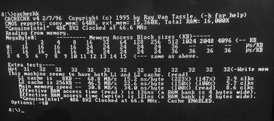

Reply 4 of 36, by Namrok
Well, these results are disheartening.
The attachment 20230919_100410.jpg is no longer available
The reported RAM read time is nearly 4x yours. However that may be skewed by access times past 512 KB sizes being enormous compared to all the rest, which while slower, seem competitive. I'm just running 2 banks of 30-pin SIMMs.

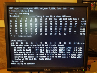

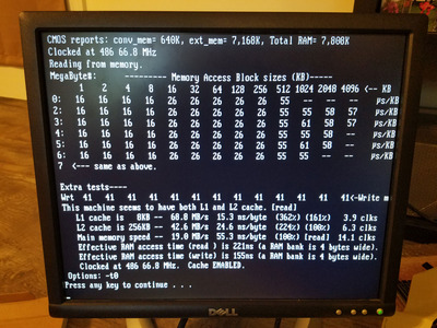

Reply 6 of 36, by Namrok
Yeah, I messed around with AMIBIOS some. Dropped memory timings to 3-1-1-1 from 3-2-2-2 for a start. Also dropped, I think it was "Cache Read Option" to 1 W.S. from 2 W.S. The biggest change I noticed was turning on FastPage. Numbers are looking a lot better from where they were. Still off from yours. I did pick up a single extra FPS in the Doom timedemo.
The attachment 20230919_103617.jpg is no longer available
Edit: Alright, getting closer. Close enough that I'm happy enough with it.
The attachment 20230919_113801.jpg is no longer available
I believe the settings I finally arrived at were
  • Cache Read Option: 2-1-1-1
  • Cache Write Option: 0 W.S.
  • DRAM Type: FastPage
  • DRAM Wait States: 0 W.S.
  • Fast Gate A20 Option: Enabled
Raw memory throughput aside, it's putting me right where I'd expect from Phil's Ultimate VGA Benchmark Database. 2973 Realticks in the Doom benchmark, which is solidly middle of the pack for AMD DX2 results on that sheet.
Edit2: Checking this 486 Chipset Race I found, the performance of my PC Chips, SARC chipset motherboard is probably about right. In fact, I wonder if I was able to use such aggressive memory timings and get away with it largely because the chipset/motherboard itself is such a laggard.

I saw some conflicting information about what sort of voltage the external CMOS battery needs. The first source I found said 6V so I had been doing that, but another said 3V so I backed down to that. Doesn't seem to make a difference, so I'm gonna stick with the lower voltage and hope the 6V battery pack didn't do any harm.

Reply 17 of 36, by jakethompson1
I don't think you did any harm with 6V. On these boards it usually goes through two diodes anyway which would drop it below 5V which is the voltage it receives when powered on. You may find that 3V is enough to hold the settings when powered off, but that the clock freezes in place until turned back on. When I attempt to power these boards using a single CR2032 that's the symptom I get.
