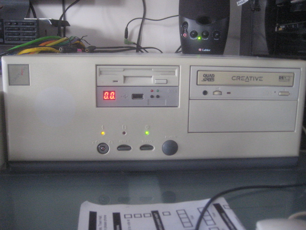

The USB Floppy emulator I got after checking out Mau1wurf1977’s youtube channels a while back. So big thanks to you for discovering this for me. I still use floppys a fair bit for boot disks or quickly transferring smaller files and these things are cheap, basic, and no more boot disk errors due to my disks slowly dying. I wish it was white not grey but doesn’t look that bad in the poor light where it lives.
Looking around on the net and I discovered what the hole next to the green LED is for
Just like whoever it was out there on the net somewhere my loading LED wasn’t bent into place, (that white rectangle printed underneath the LED says RED LED and the one next to it says Green LED) it’s strange as it’s much more useful than the green LED which just indicates power. Lucky its easy enough to bend into place.
For the moment I’ve just got the one drive and use the software on my day to day PC to copy files between the 2, but it works well and I will start putting them in all my retro builds. Network is great for large transfers but this is a god send for replacing unreliable boot disk’s or a quick file copy in dos.

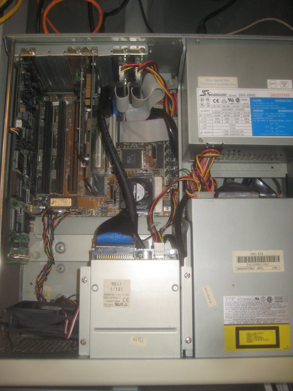

Also got a round floppy cable to make the case a bit more tidy. Slight issue there as the Sony disk drive was keyed the wrong way round (typical Sony great product but make it not compatible with anything else) Still a small plastic tab was no match to a sharp kitchen knife and I even managed to stop before cutting any of the cable. 😎
Also got a round IDE cable for the boot HDD and CD-ROM. In the end I could actually run this under the power supply but it still takes up less space which is good thing as the parallel and serial port header, floppy and 2 IDE connectors are all located together. So there was a mass of ribbon cables all getting in each other’s way before.
I shortened the 2 CF card readers ribbon cable but as they sit right next to the motherboard IDE connector there was no reason to get a round cable. After my recent trouble they are working fine now as secondary master and slave. I left a real hard drive for the OS as this gets constantly written to plus it has a 2nd partition I use as a dumping ground. The CD-ROM rarely gets used. So the HDD gets the primary IDE channel pretty much to itself. With the CF cards where all the games located on the Secondary IDE, should they need the CD-Rom the Physical HDD is no longer doing anything so the Channel is left alone for the CD-ROM. I didn’t actually plan that but it worked out well.
I’ll admit the CPU heat sink is a bit over the top but it was spare so it’ll stay. It’s just a cheap Akasa Athlon heat sink without the fan. It used to get warm but not anymore with the case fan. Plus it’s still am AMD CPU so its allowed 😉
I added a 92mm fan that came with the Zalman CNPS6500B-ALCU flower heat sink, I just cut the end off and used an old 12v fan molex plug so it’s running at the full 12v so any noise I save from removing hard drives is back but really you don’t notice it above the power supply fan anyway. I don’t think it’s really needed but the fan wasn’t being used, AT cases never had any air flow to speak of so it can only help. With it slightly angled at the CPU it doesn't even get warm anymore
