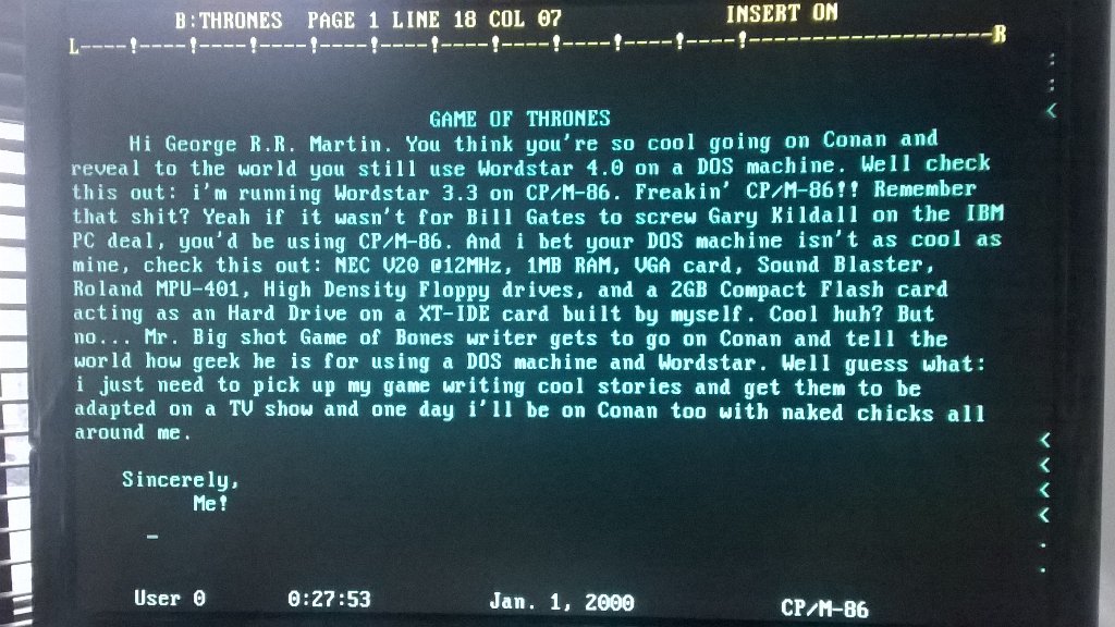

Reply 76 of 79, by carlostex
I've been kind of busy with AT2XT and XT-IDE adapters activities but in the mean time i've been able to progress with this machine even further.
*WARNING WALL OF PICS!!*
I played a bit more with CP/M-86 and found out an 8080 emulator that makes use of NEC V20 8080 instructions. The result is, i believe, much faster and accurate emulation. I ran Zork Trilogy natively for CP/M-86 and then tried Hitchhiker's guide to the Galaxy for CP/M-80.
WP_20160415_019_zpsli7u6yem.jpg?1461326279429&1461326280178&1461326285620&1461326294315
WP_20160415_017_zpswgztk2n2.jpg?1461326279429&1461326280178&1461326285620&1461326294315
WP_20160415_018_zpspy4jlu3e.jpg?1461326279429&1461326280178&1461326285620&1461326294315
I also sent George R.R. Martin a tweet...just for fun... 🤣
