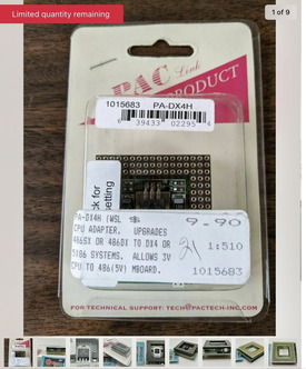

I picked up one of these the other day. The guy had about 15 of them for sale on eBay but the are all gone now.
The package reads it supports 486dx4-100 and AMD 5x86-133.
I haven’t tried it yet. Its going in my IBM PS/1 which has an Overdrive socket that only supports 169-pin CPUs.
