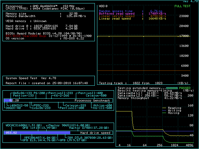

I'm using a U320 seagate 10K 36G hdd on my EISA 2740W controller.
When configuring the BIOS with Compaq's ECU, there are speed options up to 10.0 MB/s only.
HDD support is up to 8G with BIOS. Speed is 8.0 MB/s in DOS with BIOS 2.11 driver.
After loading ASPI7DOS.SYS 1.42 I get 16.8 MB/s and full 36G support (but the disk is still bored).
However, when I try the stock Win95C miniport driver, I get 6.8 MB/s only.
Using Win98SE I'm struggeling with 5.2 MB/s
There is no difference when loading ASPI7DOS.SYS in Win9x' CONFIG.SYS
9.27 KiB
2190 views
100MHz Am486DX4-100NV8T @50x2 L1=WT, L2=WB
9.42 KiB
2190 views
150MHz Am5x86-133 @50x3 L1=WT, L2=WB
Board: ABIT 486 EISA-AE4 running at 50 MHz FSB -- mod: added a socket for dirty tag ram, including dirty tag sram
DRAM: 8x4 MB = 32 MB 30 pin SIMM
CPU: AMD 486 DX4 NV8T, running at 50x2 on a 3.3 V adapter (L1 WB not possible due to board limitation, so using a WT CPU)
Timings (stable): 50 MHz, DRAM: slower & Write CAS 1T, Cache: Write Cycle 2T & Burst Read Cycle 1T, Bus: CPUCLK/6
SCSI: Adaptec 2740W (BIOS 2.11)
IDE: no-name ISA IDE with multi-io
Graphics: Compaq QVision EISA (seems to be faster than my ELSA Winner 1000)
Network: 3Com Etherlink 10/100 3c597
Sound: SB16 ISA
HDD: Seagate ST336607LW
The added dirty tag ram did not show much difference in L2 WB performance on 33 MHz but on 50 MHz.
Tag rams are 20 ns, cache rams are 15 ns.
3c597 windows 9x performance is 14.4 MBit/s SMB1 (file cache) and 12.2 MBit/s (non-cached).
What plain HDD speeds have you noted at Win9x?
Do you have any idea where I can get a newer or faster Adaptec Win9x miniport driver?
