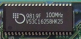

Reply 11 of 29, by swaaye
They run at 66 MHz but the wait states make it so that the RAM doesn't have to respond at 66 MHz.
Look up video card specs because many of them used FPM/EDO DRAM. You can look up part numbers. And there is well-known info about memory clocks for Voodoo 1/2 cards, for example.
SDRAM is synchronous because it doesn't have those wait states.
    16.15 KiB
    4252 views
    Voodoo2 EDO DRAM chip. 25ns 100MHz.
