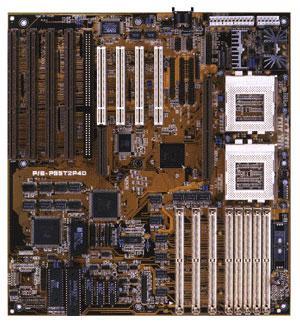

I am about to build an ultimately '' ol' hardware compatible '' + ''efficient computing power '' machine. The specs are the following (for now & adding available pictures):
Asus P55t2P4D Dual Socket 7
256MB EDO 50ns (so far have 128MB)
Matrox G200 w/ tuner 32MB SGRAM PCI
2x PCI Voodoo2 SLI mode
USB2.0+PATA+SATA PCI add-on card (some chinesse brand)
EISA LAN 2x RJ45 (10Mbit + 100Mbit)
EISA SCSI ultra 160
some ISA sound card -> your recommendations !!!!
System drive XP: SCSI ultra320 74GB 15k RPM Seagate Cheetah
DOS + win98 drive: PATA 20GB Seagete Barracuda II 5400RPM
Tower AT 300W UPS
Mobo:
G200:
the bus addon card:
The board isn't actually the same, just rip out the additional power plug, ASUS just made som VRM improvements for split voltage control...
So this is going to be built hopefully during the next week, I got everything except the CPUs and the G200, which are both now being sent from UK...
Very nice machine for ultimate compatibility with MS-DOS apps and games (thus using the G200 for its superior performance in 2D graphics) + the voodoos for better OpenGL & glide stuff under XP on the other hand 😀 The only miss is the sound card, can anybody advise a very good one, but not resourcefully exhausting?

Reply 1 of 29, by Old Thrashbarg
That looks like a really sweet motherboard. I've never seen one of those before. A couple points I notice about the planned system, though:
First off, XP seems like a really bad idea on that system. Yeah it'll run, but it'll suck. You'd be much better off going with Win2k... you still get the benefits of a (comparatively) modern OS, with much lighter footprint.
Secondly, don't get your hopes up for smooth sailing with that PCI combo card. The Via disk controllers are notorious for being troublesome in getting them to boot, even in newer boards. They work fine for storage drives and whatnot, but as far as running an OS from one, expect difficulties, at best.
Also... a U160 EISA card? I think you may have something mixed up there. Even 40MB/s UW SCSI controllers are uncommon, since the bus only supports about 33MB/s anyway. U160 would be a complete waste on EISA, and I quite doubt such a thing even exists.
As far as a soundcard goes, I know the Yamaha YMF7xx, Crystal CS423x and ESS Audiodrives work pretty nicely with everything from DOS on up to XP. Those are also pretty common and cheap, and have generally decent audio quality.

We'll see about the XP, of course you are right, Win2k IS definitely lighter, but just giving it a try...
The via will not be used because there is an IDE onboard...
the U160 - I'm not sure if it is that, it should be at leas FAST-2 solution, I'm gonna check... Of course EISA wouldn't suffice enough, as you described in easy math...
thanks for the sound info, will look onto the ebay.

Reply 7 of 29, by swaaye
I've seen XP run smoother than 2K on old Pentium II hardware. You just need to have enough RAM, like >192MB.
On the other hand, both XP and 2K were pretty sluggish on a dual Pentium Pro 233 (1MB L2 each) box with 256MB that I set up once. You may not want to mess with NT5 at all. Older NTs are rather useless for us, but I imagine that it is what was run on this sort of hardware.

Reply 8 of 29, by Shodan486
That's very dissapointing that the 1MB cache did not help much...but the MMX should be a help...unfortunately I have finally discovered the bus frequency for the SIMM:
50ns are 20MHz
60ns are around 14MHz
70ns are around 12MHz
So if this board had the DIMM slots implemented, it would be easy for the to load XP. Was the board equipped with SIMM slots?

Reply 9 of 29, by swaaye
I don't think MMX helps with Windows XP performance at all. It does help with some games and maybe parts of DirectX. What will help XP compared to a regular Pentium is that the P55C has 32K L1 cache.
SIMMs on a Pentium or Pentium Pro mobo run at 66 MHz with wait states. This is the same clock rate as the system bus and L2 cache. The performance difference between SDRAM and EDO DRAM at the same clock rate is not that great, especially if you have L2 cache. SDRAM didn't show its clear advantage until it went to 100/133 MHz.
There really isn't an inherent advantage to DIMMs over SIMMs. SIMMs are 32-bit, meaning you need two to fill 64-bit DRAM banks. DIMMs are 64-bit, meaning you only need a single DIMM for a 64-bit bank.

Reply 11 of 29, by swaaye
They run at 66 MHz but the wait states make it so that the RAM doesn't have to respond at 66 MHz.
Look up video card specs because many of them used FPM/EDO DRAM. You can look up part numbers. And there is well-known info about memory clocks for Voodoo 1/2 cards, for example.
SDRAM is synchronous because it doesn't have those wait states.
Reply 12 of 29, by Old Thrashbarg
I've also run into issues with XP not even wanting to install on older machines... like a dual PII 300 system I have here, 2K works perfectly, but XP hangs during text-mode install.
As far as the speed of SIMMs, yes, there are wait states involved, but also, the "ns" rating on EDO denotes the total access time, while the rating on SDRAM just states the cycle time. So 25ns EDO actually has a 10ns cycle time, same as 10ns SDRAM, and 60ns EDO generally has about a 25ns cycle time, which would make it good for ~40mhz actual speed (or faster, with wait states added).
