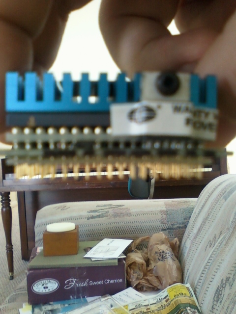

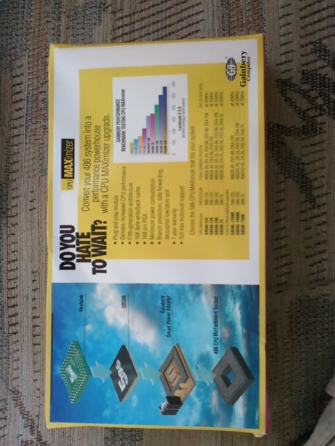

Just a quick update. I was at the Albuquerque Balloon Festival last weekend and this weekend I am at a Madrigal Competition with some of my students so I have not had much time, but the cyrix processor came so I thought that I would post a picture or two. (or three or four 😊)
The CPU is a gainberry CPU upgrade so the cpu comes on an adapter that has a voltage regulator on it.
I will try the CPU as soon as I have time, probably next week. The motherboard has an updated bios dated 1994. The bios currently on the board is dated 1992, so I will update the bios before I try the CPU.
    166.18 KiB
    1976 views
    Shot so you can see the adapter the CPU sits on.

    Top Shot of the CPU
    199.61 KiB
    1976 views
    Box Front
