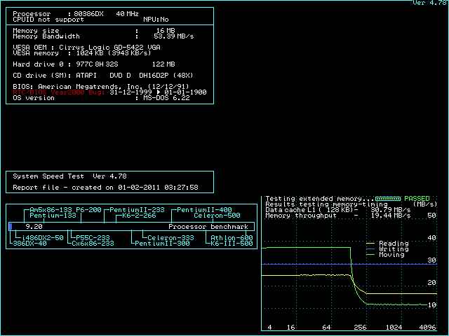

I am still wondering a bit why my system shows double memory moving speed beyond the L2 cachesize than the other systems...
(Image down on page 3)
That is odd... sometihng to do with the large 8MB SIMMs perhaps?
I use usual 4 MB SIMMs x8 for the 32 MB RAM. Nothing really special.
