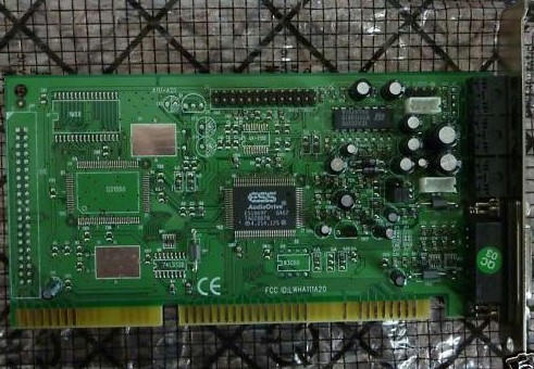

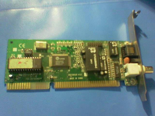

Network card in the 486:
Sound card (mine one is OEM, it says Compaq premier audio)
PS:When you start posting about the IBM 5150 please PM me
PS/2Thank you for describing all about that 286 mobo, now i know what means MFM and why the FDD cables have a twist
Reply 50 of 70, by DonutKing
That just looks like standard 16 bit ISA cards. Some of the cards I used in this system were only 8-bit and only had one connector, while 16 bit cards had the two connectors that you see in those pics.
Reply 51 of 70, by sebaz_ri
The point is, i want to know if i can use this type of cards in a 286 system?
