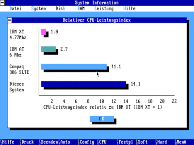

As clueless1 said. Best you can yo is to try to find out 386-ish speed by running some old benchmarks/diagnostics tools.
For example, Central Point's System Information can show how your system compares to others.
But keep in mind this doesn't resemble real-world performance.
Some of these programme do measure speed by measuring how many
cycles some instructions need to perform a given task.
    34.62 KiB
    4968 views
    System Information, German (couldn't find another screen shot)
