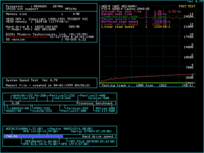

Packard Bell 386SX-II @ 20MHz and 4MB of RAM (and 8MB, but a glitch prevents all 8MB from working)

Not bad memory scores for a 20MHz 386SX. I've seen 40MHz DX systems that barely do better than that.
Reply 227 of 325, by Geforcefly
They do look very good, but that might be due to a glitch. The RAM I used for the run with two 4MB modules installed were TI 60ns 4MB 3-chip modules. However, they aren't exactly 100% compatible with the board. Even though it saw 8MB, the BIOS failed the memory check at 5MB. Yes, I tried different combinations of those modules since I have 4 of them and all fail at the exact same spot. I have two 4MB 9-chip modules on the way and will retest if they work.
DOS/Win3.1: PCChips M396F v2.2 | 386SX-33 | 16MB RAM | 420MB HDD | CL-GD5429 1MB
Win98: ASRock 775i65G 3.0 | Pentium E5800 @ 3.3GHz | 512MB DDR (TCCD) | 80GB HDD | Radeon 9800 Pro
Reply 228 of 325, by Anonymous Coward
Maybe your board has a 286-type BIOS which requires some kind of reconfiguration when the memory configuration has been altered.
Reply 229 of 325, by Geforcefly
The 9-chip modules worked and the scores are identical.

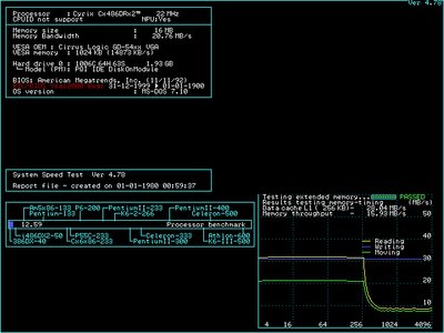

Reply 230 of 325, by skv400

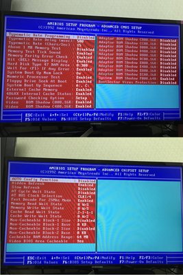

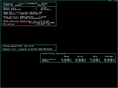

After Install CPU Cooler. My Cyrix 486DRx2-66's performance is increased.
CPU1 : Cyrix 486DRx2 66MHz (L1 WT,L2 WT)
RAM : 16MB 60ns (4MB x 4)
M/B : Aquaris MB-4D33/50 3/486 VLB Motherboard (OPTI 495SX)
I/O : Promise EIDE2300 VLB E-IDE
HDD : PQI DiskOnModule 2GB E-IDE
155.38 KiB
2023 views
79.88 KiB
2023 views
Speedsys Data
904.41 KiB
2023 views
BIOS Settings
and I ran the Doom benchmark with five ISA / VLB graphics cards to check for improved CPU performance.
can see this thread. Cyrix 486DRx2 66MHz CPU with a cooler, performance has been improved.
Youtube Channel : https://www.youtube.com/channel/UCeaVPa3VMe9nUGDtFtVzvDQ
Reply 231 of 325, by feipoa
I like your BIOS options for cache and RAM timings. I haven't seen a "Cacheable RAM address range" option in these BIOSes before. Does it go higher than 64 MB?
Slow Refresh should be enabled for optimal performance, assuming your RAM supports this. Most do.
You mentioned that using a CPU cooler improved performance. This seems very odd to me. Could you benchmark DOOM with the cooler and without the cooler? What are the two scores?

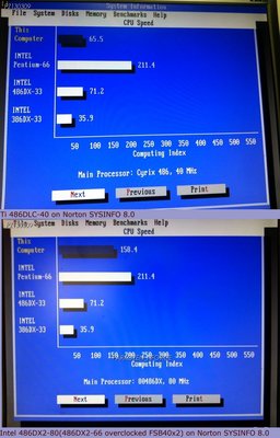

What is your CPU score from Nortin Sysinfo? Mine is 65.6. For some reason, the number is not showing on the graph from your screenshot.

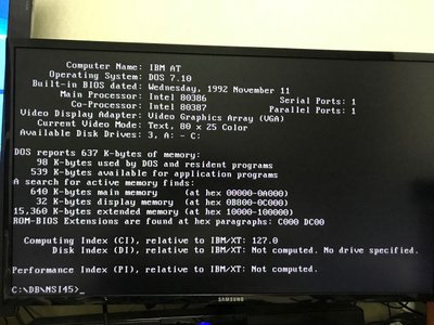

Score on nortion Sysinfo is 93.1. but this is incorrect.
1.23 MiB
1997 views
If use FSB 25/33 DX2/DX4/5x86 CPU on OPTI 495SX/SLC Chipset Motherboard. Norton sysinfo 6.0 or highter version outputs a different value than the actual one.
if use DX(25,33) or FSB 40 CPU(486DX2-80,486DX4-120 and etc). output correct value.
The solution is to use version 4.5 of Norton Sysinfo.
93.59 KiB
1997 views
486DRx2-66's CPU Score is 127.0

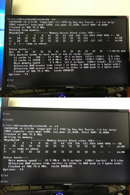

For cachechk, my L2 cache is at 33.5 MB/s, which is slightly slower than your 34.7 fps. For RAM read speed, I got 16.1 MB/s, while yours is only 9.4 MB/s. Is that correct? The worst speed I've seen was around 14 MB/s. Could you report the cachechk RAM write results? e.g. cachechk -w -d -t4
my cachechk is can't run with option -d.
i ran cachechk -w -t4 , and cachechk -t4
455.2 KiB
1997 views

The best memory read times tend to come from SiS Rabbit-based boards, at 23.6 MB/s.
My Motherboard's Memory performance is so poor..

Reply 233 of 325, by skv400
option only available 4M,8M,16M,32M,64M.
If Enable Slow Refresh. Speedsys score and Doom fps reduced. maybe 3~5%.
My Memory is 60ns FPM Memory
There was a slight improvement in the use of VLB graphics cards and a big improvement in the use of ISA graphics cards.
