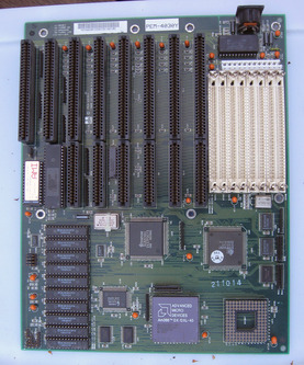

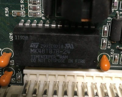

Looks like your PEM-4036 has a lot smaller PCB foot print compared to my PEM-4030Y, thus I bet the results at 50 MHz will be a lot more favourable to the 4036. Also, I'm not sure if the RTC module on mine is compatible with the 12887. Mine has some RTC module that I haven't come across before.
55.06 KiB
1484 views

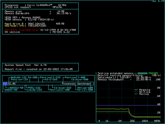

In this build I'm using a DRx2 so this might not count as a "real 386", but I hope it's interesting to see anyways. My goal with this project is see how much I could have upgraded my first PC that I got in '92 without swapping the mainboard.
CPU: Cyrix DRx2 33/66 with green heatsink
FPU: none
Motherboard: FIC LEO 386-SC-HG (like thishttps://www.ultimateretro.net/de/motherboards/5265)
Chipset: Symphony Labs Haydn
Cache: 128kB 15ns (tag 12 ns)
BIOS: Swapped the Amibios with a MR BIOS I found for another Haydn board
Memory: 4x4MB 50ns
HDD: CompactFlash 512MB
Video: ISA 512kb AVGA2 (Cirrus Logic 5402)
    6.65 KiB
    1293 views
Reply 295 of 325, by GigAHerZ
@JohnBourno, looking at the picture i got confused that there's only one level of cache. To my knowledge, every 486 type cpu has at least some tiny amount of on-chip cache.
Started to google your cpu and found that you've already started a thread here in vogons on enabling the L1 cache somehow. Good luck, i hope to see another speedtest result once you fix it! (Y)

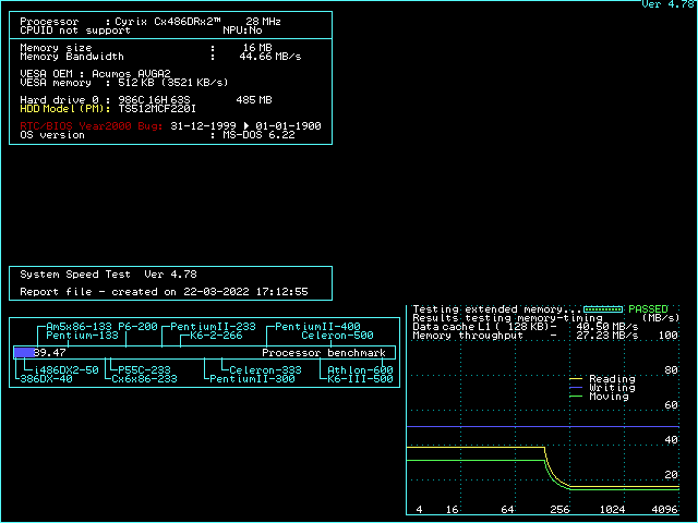

And this is the same setup but the DRx2 overclocked to 41/82 MHz .. with a CPU fan added on top of the heatsink of course.
    6.67 KiB
    1288 views

GigAHerZ wrote on 2022-03-23, 11:44:
Good eyes! I'm not sure why the 1 KB cache doesn't show on speedsys, but it definitely on. When I test my SXL2 with 8 kb of L1 cache on this board you can definitely see the faster "ramp" in the beginning. Perhaps the 1 KB is too small for the memory test algos in speedsys?
Reply 298 of 325, by GigAHerZ
JohnBourno wrote on 2022-03-23, 11:46:
I have one 486DLC with 1kB of on-chip cache as well. If i remember correctly, speedsys did show it on graphs.
Maybe at one point i have a bit of time to check it once again. Especially now as i have 90MHz crystal on board that works. 😁
