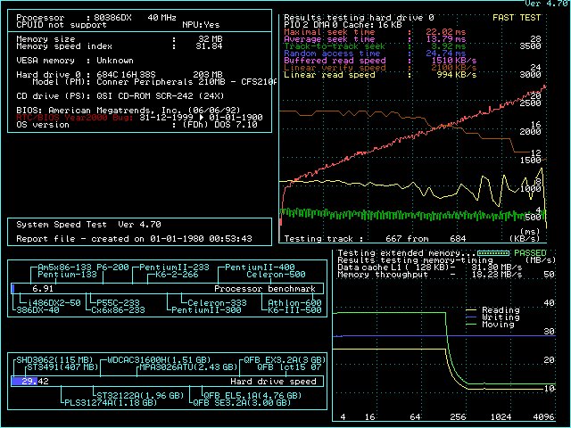

Reply 67 of 325, by huubwen
Motherboard: PC Chips M-321 rev 2.6
Chipset: PC Chips
Cache: 128k 20ns
Memory: 32M Parity
CPU: AM386DX/DXL-40
FPU: Cyris FasMath CX-83D87-40-GP
    98.75 KiB
    3769 views
    Speedsys 386DX-40 M321
Reply 68 of 325, by feipoa
huubwen, can you let me know what chipset that PCChips board uses? You'll probably need to use some software utility to find out as PC Chips re-branded the chipset with its own markings.
Also, is your memory speed set to the fastest speed? Your memory throughput seems really slow.
