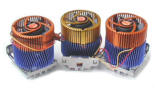

I'm pretty sure that the 3-hole clips for Athlon coolers match up with the notches on socket 3.
Some of them do, some of them don't. The spacing is right, but the outer tabs on Socket A aren't as wide as the Socket 3 tabs, so if the clip on the Athlon heatsink was made to tight tolerances, it won't quite fit.
I suppose you could take a file to the edges of the tabs to make it work, but that's a little risky.
