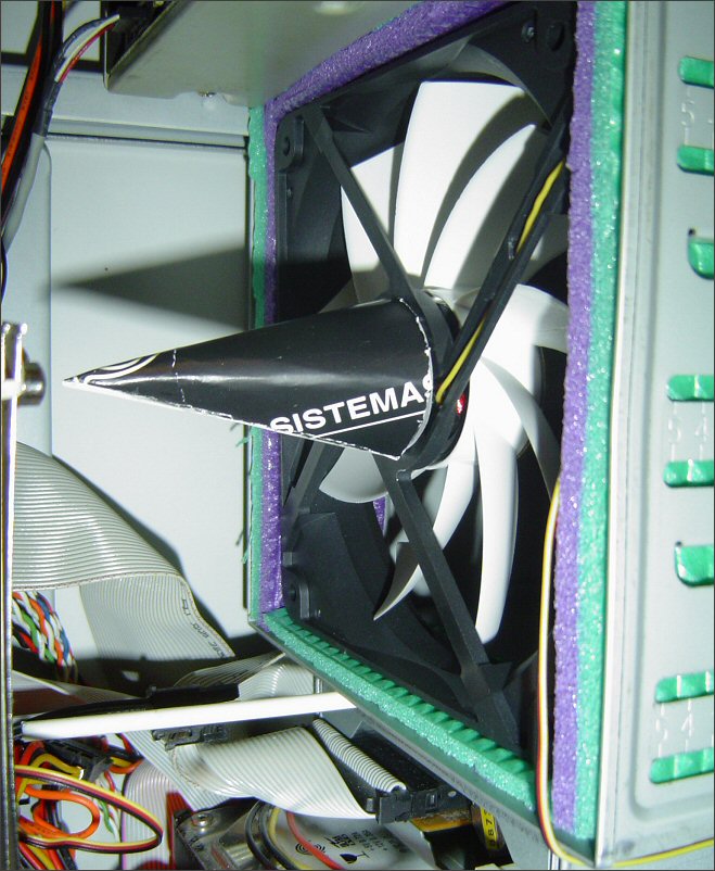

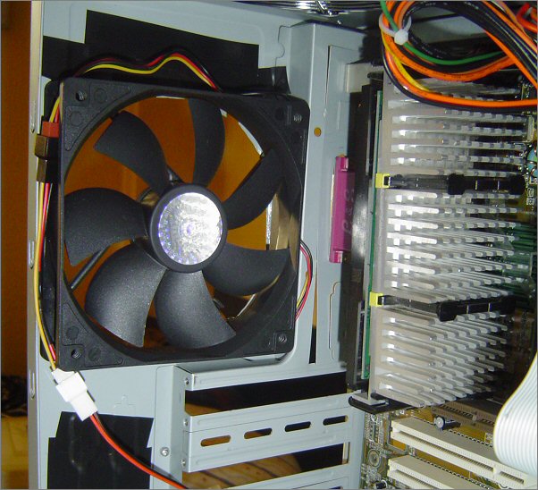

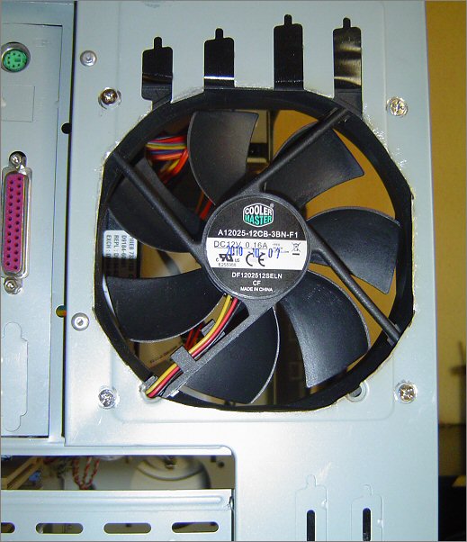

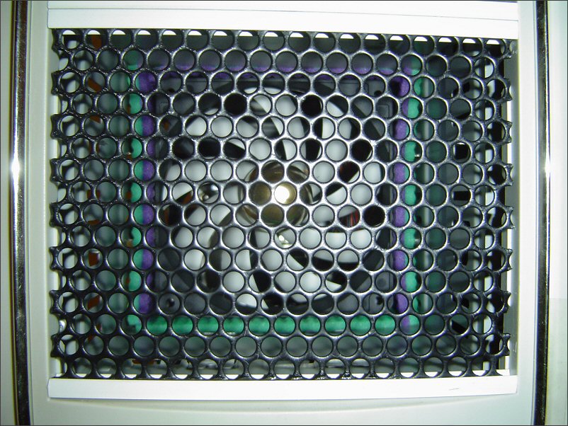

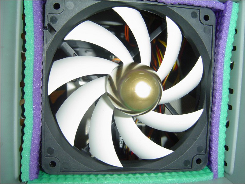

Reply 12 of 38, by TELVM
cdoublejj wrote:
... I almost whole sawed out the back for some fans but, figured since heat rises the ones on the top would be enough. the top 120mm fan is going bad and makes noise unfortunaty. also i'm not sure if put an intake fan in the 5.25 if it will be of any use if i have a 120 at the top, i'm not sure if the 120 would just suck up all that air from the new intake fan in the 5.25, so i though about mesh covers, if i could find them ...
This is what I'd do:
- Discard the middle top fan, and seal its hole.
- Saw in the back panel to make room for the largest extracting fan that fits.
- Put the largest intake fan that fits in the front 5.25s.
- Another intake fan at the lower front blowing the HDDs (from the pics seems you already got one).
Let the air flow!
