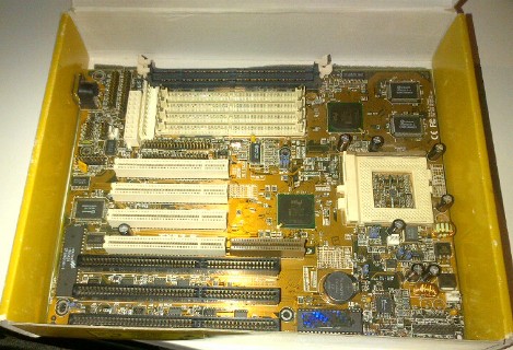

Anyways, my planned P166MMX system specs are:
ASUS TX-97-E rev 1.04 Mainboard
53.3 KiB
7842 views
69.96 KiB
7842 views
P166MMX (lower voltage version-runs cooler than beige 5v version - enough to use passive heatsink I believe)

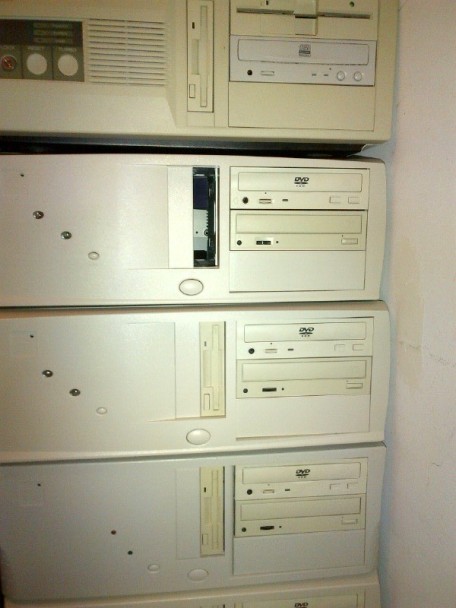

One of my "semi-retro" AOpen desktop format ATX case...don't have a turbo header on my mainboard 😒 so I don't need one with turbo switch or LED

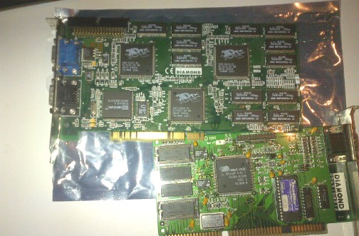

Diamond Monster 3D II PCI 8MB (Voodoo II)
Diamond Speedstar64 ISA 2MB
71.49 KiB
7842 views
Sound Blaster 16 (CT2230) with NEC XR385 (from that dude in China also)
