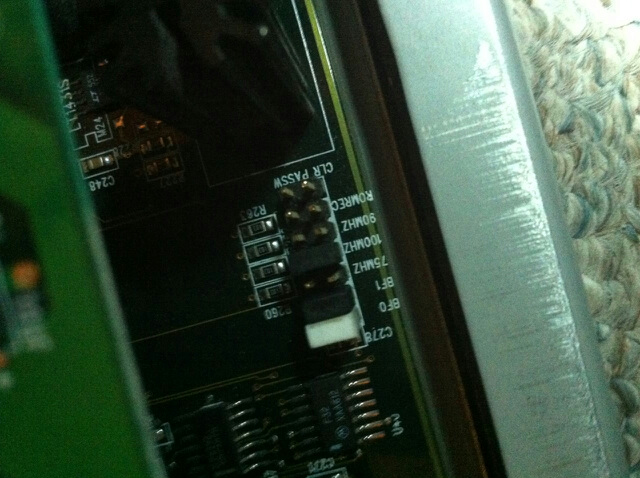

Mau1wurf1977: So glad to hear that someone tried that....I was looking all over Vogons for an example of this! I was thinking of doing that for an NEC Ready 133Mhz Pentium system I have. I tried changing multiplier settings, but not on the fly because I was worried I would fry the motherboard...but since I have a back up system because I just picked up another NEC ready system recently 🤣 , I may be willing to risk trying it.
Has anyone tried hooking up an external switch to their multiplier and/or their motherboard's FSB jumpers to change on the fly? I think that might be a good way to slowdown my socket 7 system. Not too much of a range, but it may work well for some games. I would still need to disable the cache for older sierra games to work properly with my MT-32 and such.
Here are the jumpers on my NEC system.

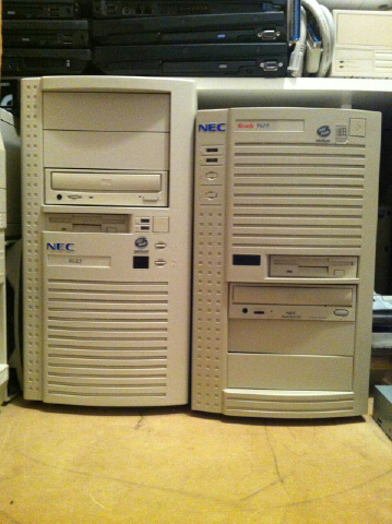

Reply 22 of 59, by badmojo
Just promise me that you won't mount the switches in the front of those mean looking NEC cases 😎 I haven't seen one of those before.

Reply 24 of 59, by retrofanatic
Ya they are pretty rare actually...they both come with IR remotes as well for windows. I only have one and it's almost impossible to find another for my 2nd system because of the apparent rarity of these systems.
🤣 I promise I won't...I may try to mount a couple on an old 5.25 bay cover I can change out later or something like that. I'm not going to mess with it...too hard to find another and I usually prefer a simple "stock look" to my retro rigs anyway.
