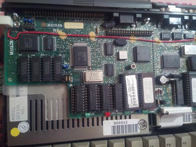

I think there is a way to upgrade this laptop to 2.5MB (640kB + 1920kB EMS)
Here is what I found after reading 82C100 data sheets
Still untested
Set JP1A and JP2A to 1-2 (the 2 jumpers between memory banks)
Put 4 514400 in the DIP20 sockets U8-11 with pin 4 and 5 lifted out
Connect JP1A 3 to U8 and U9 pin 4
Connect JP2A 3 to U10 and U11 pin 4
Connect 82C100 pin 88 to U8 U9 U10 U11 pin 5
I don't think the BIOS support this configuration, there is no strings for more than 1MB
Patch the BIOS or make a device driver that is loaded before EMS driver
Swap everything that is loaded in memory, below and above 512k
Set 82C100 register 4Bh bits 3:0 to Fh (this swap memory between 0-512k and 512k-EMS)
Now you can load EMS driver

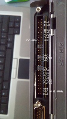

Reply 55 of 103, by StickByDos
I've already got the DRAM chips but I prefer identifying extension connector before I burn my laptop
Here is what I've found so far
148.6 KiB
3609 views
And here is the J1 connector for the HDD daughterboard
8 IRQ5
3 4 32 36 37 40 GND
5 6 35 36 +5V
21 DRQ3
23 /DACK3
34 +12V
For your dead HDD, there is someone on a French forum with a V86P with the same symptom, it seems that it is actually the 12V path inside the daughter board that is broken

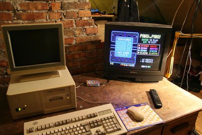

Reply 56 of 103, by ciernioo
Hi Bjt! Thank you very much for your work on the CGA -> SCART adapter. I`ve built it according to your schematic, and it worked perfectly for my CGA + TV:
308.32 KiB
3490 views
This is sooo much fun!
My Z80 computer project http://ciernioo.wordpress.com/
Reply 57 of 103, by bjt
Looks great and great choice of game. As mentioned before you may want a slightly larger resistor on the sync output if you used my schematic. I bumped the sync voltage a bit for my particular TV.
@StickByDos: Thanks for the partial pinout, will be great if you identify it fully. I've looked everywhere but I can't find a manual for this machine, I suspect the pinout might be in there.
