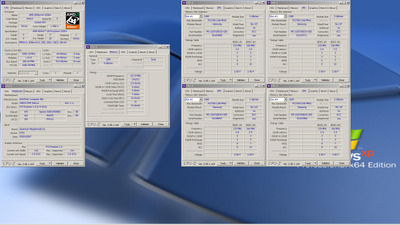

I also tried 8Gbytes of Ram on my S939 Systems.
My Asus A8R32-MVP (ATI RD580 Chipset) does recognize and utilises all of the 8Gb (4x2 Gb Samsung PC2700 ECC RDIMMs) with an Athlon 64 3200+ (Rev. E6).
Unfortunately, with my Rev. E4 x2 3800+, the System doesn't Boot at all. Even with everything at stock Settings and Hardware Memoryhole enabled. (Bit of a bummer, given that this very CPU is my FIR ST! A64 x2 I accuired in 2007).
On the other Hand, the Opteron 180 (also Rev. E6; pillaged from my Sun Ultra 20 Workstation), does work fine with all 8 Gb of RAM.
So I can confirm the Theory, that 8 Gbytes are only possible with Rev. E6 CPUs (at least for me) and furthermore, Asus also did implement the possibility of using 8Gbytes on this ATI based Board.
For the Record:
The Sun Ultra 20, which uses a Tyan Tomcat K8E S2865, nForce4 Ultra-based MoBo (or rather an OEM version of said MoBo with a Sun custom BIOS), does not boot even with a 2x2 Gb setup of the above mentioned RAM.
More details are shown in the Screenshot (taken under Windows XP x64):
309.11 KiB
552 views

EDIT:
Rev. E4 CPUs ARE 8Gbytes capable! Or at least MY Rev. E4 X2 3800+ is. After a couple of hours of work, my setup does boot and utilises the full 8Gbytes of RAM. Same Board, same RAM.
I had to go a bit medieval on the BIOS, as AFUDOS did not update the Boot Block (IMHO AFUDOS is a terrible Tool....) After bricking the Board multiple times, I discovered, that the CMOS had some Bit Rot.
With a new CMOS and a clean CMOS flash, the Board now boots 1st try with all my CPUs.
