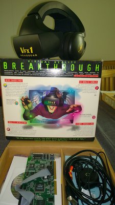

Nice post about your Vfx1 😀
Here is my gear, but boxed and not been used for about 15 years. I think i missing a driver disk, but everything else seems to be complete.
245.31 KiB
2583 views

Drivers aren't that hard to get hold of. Just sign up on the forteVFX1 yahoo group and you get access to the drivers and a bunch of other cool things like the SDK.
