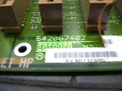

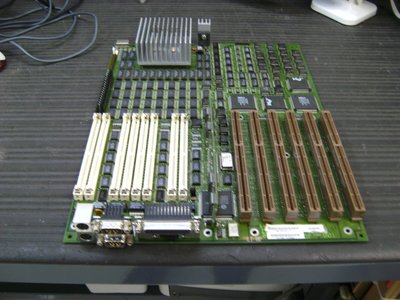

Reply 45 of 81, by Intel486dx33
I was looking at this one. I think it is an HP or Digital. and I think it has an onboard Pentium 150mhz CPU.
What do I need to get it working ?

Reply 46 of 81, by Anonymous Coward
I don't think this board is even x86. I think it uses an Alpha CPU.
Reply 47 of 81, by GL1zdA
This is a DECpc AXP/150 board:
http://john.ccac.rwth-aachen.de:8000/alf/axp150/
https://en.wikipedia.org/wiki/DECpc_AXP_150
Reply 48 of 81, by Intel486dx33
GL1zdA wrote:
This is a DECpc AXP/150 board: http://john.ccac.rwth-aachen.de:8000/alf/axp150/ https://en.wikipedia.org/wiki/DECpc_AXP_150 […]
Oh, That is even better. More rare. I always wanted to have a DEC-Alpha.
What do you think I need in order to get this working and what OS has built in drivers that works best with this motherboard ?
