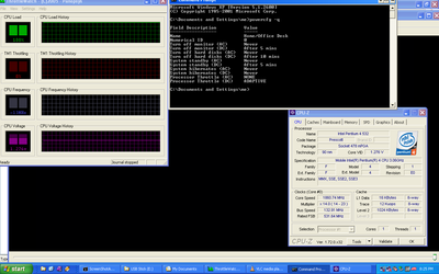

Reply 19 of 24, by pewpewpew
idspispopd wrote:
Do Throttle Watch or HWiNFO32 tell you anything about thermal throttling?
67.4 KiB
2379 views
Must say I don't understand how this is working.
Wikipedia: "Under Microsoft Windows XP, SpeedStep support is built into the power management console under the control panel. In Windows XP a user can regulate processor speed indirectly by changing power schemes. The "Home/Office Desk" setting disables SpeedStep, the "Portable/Laptop" power scheme enables SpeedStep, and the "Max Battery" uses SpeedStep to slow the processor to minimal power levels as the battery weakens. The SpeedStep settings for power schemes, either built-in or custom, cannot be modified from the control panel's GUI, but can be modified using the POWERCFG.EXE command-line utility."
I'm on AC power, in Home/Office setting. So what throttles it to 1860 when it's under load like this? FWIW it went back into the 2000s immediately when VLC crashed. Slowly climbing till it BSOD'd while I was trying to get it to allow USB removal.
Did try HWINFO32. Get BSOD when I try to run it, and when I try to uninstall it...
