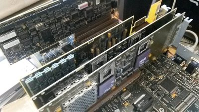

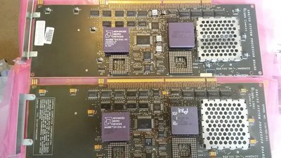

Reply 32 of 60, by 386_junkie
Systempro... in the making: -
    290.72 KiB
    3366 views
    Beast
    299.26 KiB
    3366 views
    Due core DX40's

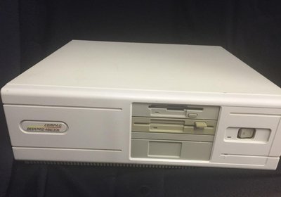

Will post more pictures / even make a thread of the Systempro later. It's specs are (2 x 386's w/ 16Kb hybrid cache) locked at 33MHz by the Crystal Osc... I have two motherboards, so I plan to mod one upto an 80MHz crystal to make FSB 40MHz. I have about 100 and something MB RAM in various sticks... most 80ns, some 70ns. Will make a proper thread post for sure.
For now... here's the rest of the family (meet 386s/20, 486/33L): -
    90.77 KiB
    3354 views
    137.32 KiB
    3354 views
