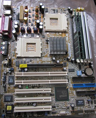

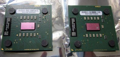

Reply 10 of 16, by petro89
Well I finally received the PCI SATA card and am in the process of putting things together. Decided to take a few pics of the bits and pieces 😊
Here are the evil twins!
519.6 KiB
2181 views
Their future home...
1.08 MiB
2181 views
Putting it together...
931.74 KiB
2181 views

Reply 11 of 16, by petro89
Well Everything is up and running! I actually went ahead and built both setups - the duallie I put in a case since I was leaning towards running that setup, the XP3200+ I simply put it together to try it out.
As expected, the 3200+ is definitely a smidge better in the few games I've tried - probably around 5 or 10% better. But doing simple things within Windows seems to favor the dual setup - it just seems to be snappier and more responsive. I'm going to continue to try different things but for now I think the dual setup is the one I'll stick with, while the 3200+ will get a nice rest in the closet 😀
Thanks again for everyone's input and comments!
