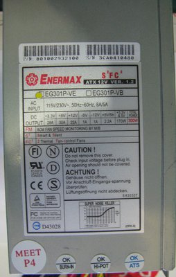

JayCeeBee64 wrote:
The Enermax PSU was fully recapped recently by a neighbor's acquaintance; he doesn't recap motherboards though (and no pics of the inside, sorry).
Awwww... I just re-capped this exact PSU for a motherboard that needed a -5V rail.
Curious as to what he used... Maybe I'll show you mine, I've got to open it up anyways, since I noticed while testing it that I put the exhaust fan in backwards. Used mainly Rubycon ZLS series. Also had to scrape away a lot of the nasty low-quality glue they used that becomes conductive when it dries out.
The motherboard needs no re-capping. Gotta love Asus boards from that era. All Rubycon. I think they started using inferior caps in the next generation 815 boards, like CUSL2.
Nice system BTW 😀

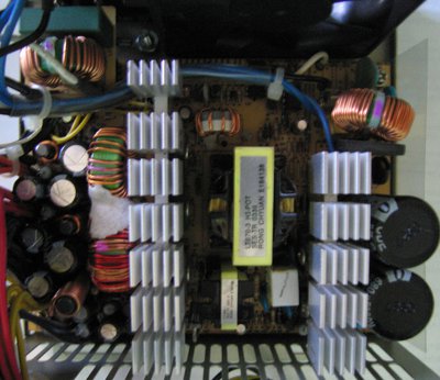

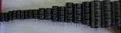

Reply 3 of 50, by mockingbird
Ok, I finally got a chance to open the thing up, because I had to switch back the left fan pointing outwards...
The 80mm fan model is B01138812H-3M
the 90mm model is B071B8812M
332.09 KiB
3896 views
756.91 KiB
3896 views
819.01 KiB
3896 views
All the 12.5mm and 10mm caps were replaced with Rubycon ZLS I believe, and the smaller caps are a mix of Panasonic, UCC, Rubycon, Nichicon, and Panasonic.
Nice supply. Had it running so far for a week or so.
