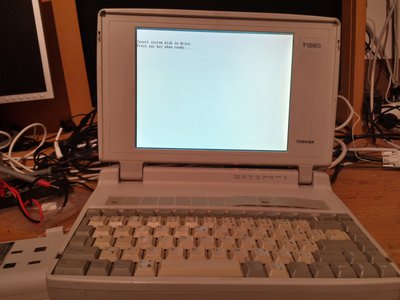

I recently got Toshiba T1850. Seems quite a used, but overal look in good condition. After applying some power in battery slot it powered on 😀

System specs:
CPU : 80386/25
FPU : 80387
FDD : 1.44MB
HDD : 80MB
Now the bad thing, both Floppy and HDD is dead. Seems like there is AT 16bit controller so it will be quite difficult to find hdd replacement 🙁 If anybody have some experiences just let me know.
Thanks for reading! Comments/ideas are highly appreciated! 😊

Cleaning the floppy drive helps a lot with those older systems.
Cleaned my own Compaq Contura 430cx floppy drive and brought it back to life. It reads all disks well again. 😊
For the HDD I need more info. Is the HDD not detected anymore and/or does the drive make some of those horrible noises.
Reply 2 of 4, by kubino
i disassembled the floppy and seems like belt is worn out... Not a big deal beacuse I'm planning to replace floppy with hxc drive, until I find any working FDD. HDD it's detected by bios (80MB). Seem like it initialize correctly on boot. But when system trie to boot it got some weird noises and system hangs for while.

Try a low level format on the drive. Might bring it back to life if its been in storage for a long time.
