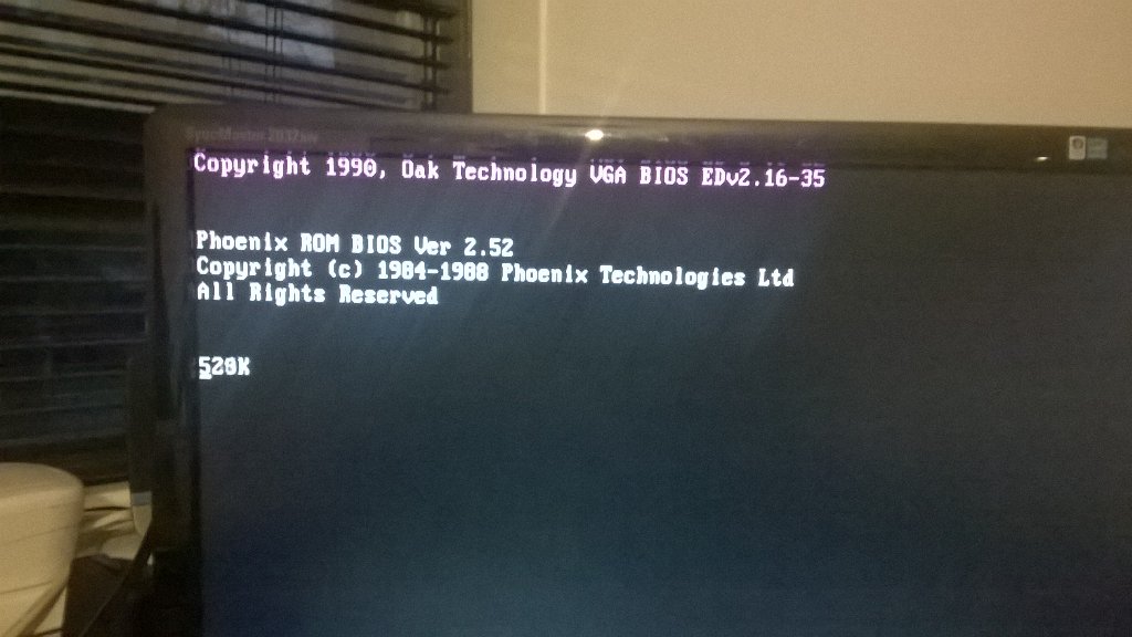

A little update. I ordered 2 brand new ATMEL 28C64B EEPROMS to replace the SGS M2764AFI EPROM with the DTK ERSO BIOS. I burned one EEPROM with DTK ERSO 2.42 and the other with PHOENIX XT BIOS 2.52. I tried the PHOENIX BIOS first and found it faster than the DTK ERSO, so I kept the PHOENIX BIOS EEPROM in the board.
Besides being faster usually BIOS upgrades for XT's don't add any functionality at all.

Here's some pictures with
Phoenix BIOS:
Turbo XT BIOS 2.5:
I like this BIOS its pretty cool. I also burned a Winbond W27E257 EEPROM with all ROM BASIC glued together which will then fit on a 32kb chip. The photo above shows the motherboard booting without an EEPROM on the ROM BASIC socket.
Below you'll see 2 pictures. The first shows that the BIOS finds ROM BASIC is available and gives you 3 seconds to press SPACE to boot BASIC. The second picture shows what happens after i press SPACE. The system hangs and a Random ASCII character appears after the CPU ID. On this picture occasion that character happened but other characters had appeared on other occasions.
So i'm wondering if i burned the EEPROM correctly. When i read the EEPROM the ASCII table matches the file i burned so maybe its the file. I got the ROM BASIC file from the package i got the BIOS from, it is basically all 4 BASIC 8kb ROMS glued together.
I would like to get this working but i don't know if these boards had different ROM BASIC from the IBM PC models.
