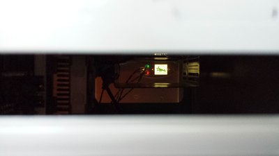

After these tasks I decided to make a BOOT test and attached all the front panel connectors.
The system came to life on the first powerup and it made a clear and happy: beep! I'm allive! 😀 The CL5446 and the 4DPS are in excellent working condition! No drama, no more problems!
The PC is purring like a kitten, the hdd makes all the right noises and the Noctua fan is silent as a wisper. EPIC WIN 4 ME!!!
gallery: https://postimg.cc/gallery/1lk67mme4/
REMEMBER MY FACE!!! SAY MY NAME!!! 😁

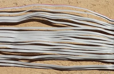

Reply 129 of 844, by Robert B
With what should I start? Hmm....this story doesnt have so much material going for it but I'm sure I can make SOMETHING SPECIAL with it! 😁
Saturday the AGER case received all of its "organs" and she almost went into cardiac arrest with all its 133MHz!!!
Next task on the LIST: WIRE MANAGEMENT!!!
I took out the FDD and 40 pin ATA cables and I did a quick test to see how they look. I really didnt like the results. Last time I rolled them up and they ended up like a GIANT FUNNEL. NOT GOOD!!!. I tried to let them be and hang like in the GOOD OLD DAYS but they looked HORRIBLE!!!
What to do? CLICK! I have an idea!
One or two years ago I saw somebody fold ribbon cables in half, then in another half, across their length and then tied them up with zip ties. I tried to do the same but the cables turned to be STIFF AS A BOARD!!! GOD DAMN IT!!!
You know what came next? 😁 EXTREME MEASURES of course.
I started by looking on the internet for some information about separating ribbon cable in individual strands / groups of wires. I found something, but as usual what I want is hard or can't be done....
I remember the 80 pin round ATA cables with their individual wires.
So I take in my hand a cutter / X-acto knife with a fine blade and I CUT THE FLESH!!! Curiously no blood comes out! Hi Hi Hi! (evil smile)
And a TUTORIAL IS BORN!
ATA / IDE / FDD RIBBON cable - MANAGEMENT or WIRE MANAGEMENT OF RIBBON CABLES IN AT PC CASES - 386/486/586 etc
Steps:
STEP 1. You take the ribbon cable you wish to separate in groups of wires. You cand choose 2,4,6,8 etc, 3,6,9 etc or any number of wires you want to group. I went straight to the NUMBER 2 for the FDD and ATA ribbon cables, after I found out that groups 10 wires arent very flexible. You can experiment as much as you like.
STEP 2. Place the ribbon cable on a glass surface with a source of light underneath. In my case I placed it against a glass window.
NOTE. First choose the cable with the most visible / bigger space between wires by placing it against a source of light. You'll see that not all cables are the same.
PROS and CONS of using the glass window:
PROS
a) better control of the ribbon cable when you cut between wires. You have a better feel of the space between wires.
b) the gravity helps by allowing the ribbon cable to stay stretched.
c) when you cut between the wires the ribbon cable follows your cutting motion because it is able to move freely.
NOTE. I saw on the internet that when somebody tried to separate groups of wires in ribbon cables, he used clips to stretch and fix the cable onto a surface. I DONT NOT RECOMMEND this, as the ribbon cable becomes rigid and the chances to cut or expose a wire are far greater.
CONS
a) the ribbon cable slides on the glass surface
b) it is harder to control the cable as you start cutting.
NOTE. THE GLASS WINDOW WASNT AFFECTED, but I have very sensitive fingers. YMMV!!!
STEP 3. The cutter / X-acto knife MUST BE sharp. with a fine blade and reasonable "high" cutting edge to fit nicely between wires.
I started from one end and I cut as much as I could, then I started from the other end. All this time I kept the cable by its connectors and I took care to keep the cable straight and under tension, as much as possible.
The FDD cable was more flexible and was easier to separate.
THE ATA cable was less flexible beeing new and it was a little harder to separate.
The SERIAL/PARALLEL cables had more tightly packed wires and the grooves were closer. It was more difficult to separate and I almost damaged cable 😁 Here I had to completely separate the gropups of wires with the blade.
TIP. If you have to stop when you cut, KEEP THE BLADE in the grooves, and just reposition the cable. If you went sideways, start lower bellow or from the other side. The jackets of the wires are thicker than you think. Inspect for damage afterwards.
NOTE. Before you start cutting straighten the ribbon cable as much as possible.
OBS.Preferably the cutting motion MUST be continuous, without stops. If you stop, start from the other end. Keep the blade straight when you cut. Otherwise bye bye cable.
STEP 4. After you have cut between two groups of wires separate them. Dont cut all the cable and then separate it.
CUT.SEPARATE.CUT.SEPARATE.REPEAT!!!
OBS1. Sometimes the blade wont cut all the way and you will have to cut again. BE CAREFUL.Sometimes is possible to separate the groups of wires even if you havent cut the material between them all the way, sometimes not. The flexibility of the ribbon cable jacket will dictate this. Dont use FORCE when you separate the groups. Faillure to do this right will damage the jacket of a wire or it will expose it and you will have to start again!
OBS2. Regardless that you have cut the material between the wires all the way or about 50% the separation of the group of wires MUST BE DONE applying force over the LENGTH of the cable and in a downward motion. NOT UP or SIDEWAYS!!! Take it step by step, centimeter by centimeter and if the groups arent separating place the cable on the glass surface and cut more material if you didnt cut all of it. DONT start from one place and pull hard.
OBS3. DONT USE FORCE. The wires are DELICATE and each cut makes them more FRAGILE. Tie the groups of wires with zip ties ONLY AFTER YOU PLACED THEM IN THE CASE and you like their position.
I MANAGED TO DO THIS ON MY FIRST TRY. FTW!!! No drama or other problems.
And there you have it! A 40 pin and kind of a round cable 😁 I wont cover the ribbon cables in a plastic jacket as I like how they look!
i still have more work to do, so GLAMOUR PICTURES WILL HAVE TO WAIT a little 😀
After I separated the groups of wires I inspected all of them to look for damage even if I already knew they were PERFECT!
I did a quick BOOT test to see if the cables are still working and as expected they are IMPECCABLE! I was nervous at first, and I tried the FDD cable. Afterwards came the ATA cable. I dont know if I will have problems with interference as some 80 pin ATA round cable had, but because these are 40 pin cable I think I'll be OK.
The entire process took about 60 or 90 minutes. I dont know for sure. This includes the taking of pictures and fitting inside the case. After this experience I can do it much faster.
Just a regular day in my life 😁 Me and my OBSESSIONS!!! 😁
I'll see later if something is wrong but for now I'M PROUD of a JOB WELL DONE! gives himself a pat on the back.
