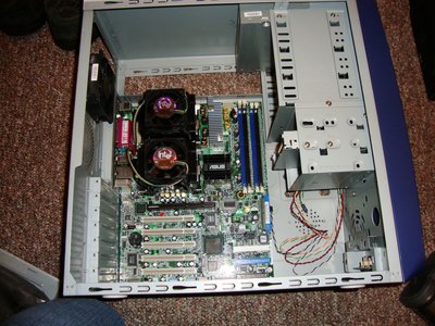

I actually just came on here to post about resurrecting mine. It was having a BIOS error last time I tried to use it. It's a cool board though.
Sneakpeak:
333.52 KiB
898 views
If you're going to junk the board *please* pull the BIOS chip! I would be exceedingly happy to get my hands on a good one. 😀

Got the new mobo today and oldy a previous owner hot glued the front panel and usb headers cables in place at one point. That's about odd.
Reply 52 of 83, by xjas
Ugh, I HATE hot-glue (or "hot snot" as EEVBlog guy calls it) cable fastening. Huge pet peeve of mine. I've seen that tons of times from "professional" PC builder shops - drives me mad.
Not as much as I hate sticky duct-tape residue though.
Reply 53 of 83, by Jade Falcon
Rank BANNED
BANNED
Getting there.
I'm now using stock heatsinks. They looked like they would do better and there u3 and not u2 thay have better mounting and surface too. Fans are ok, but I may make a custom mount for 80mm fans.

Finley I got the system up and going. Runs uber hot! That netBurst for you. But the hardware can handle it. Even the ram gets hot. Big difference from the piii and over systems I been working with for the last few years.
